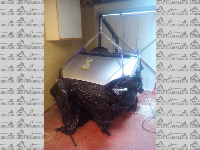

front nose just arrived
I got a front nose from a car breaker
ready to take the engine

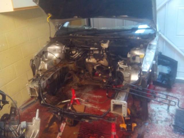

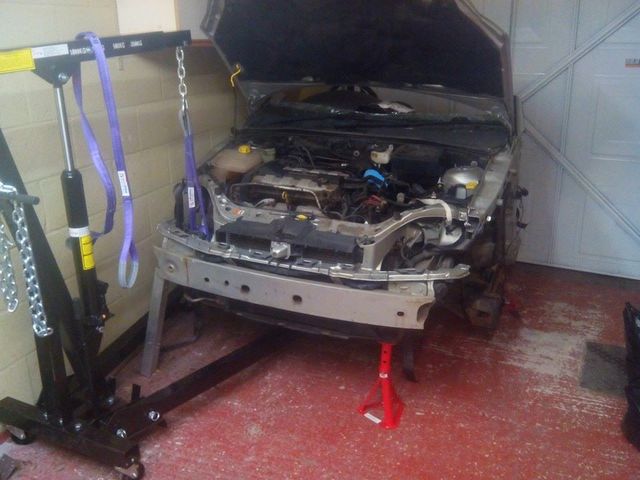

Preparing to take the engine

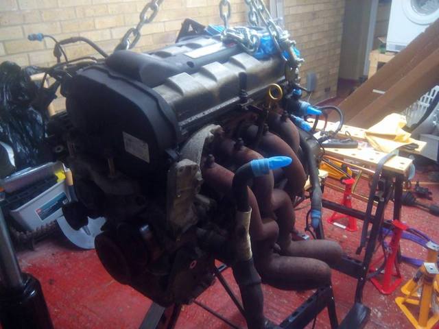

engine is out
engine is out

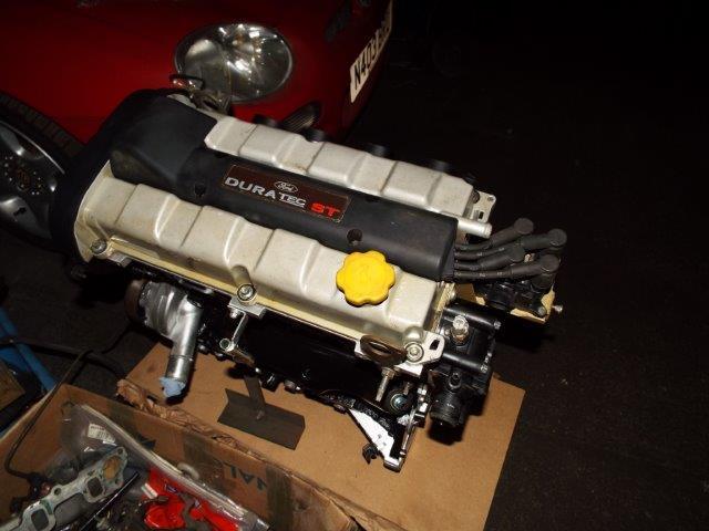

engine is off
here in very bad shape

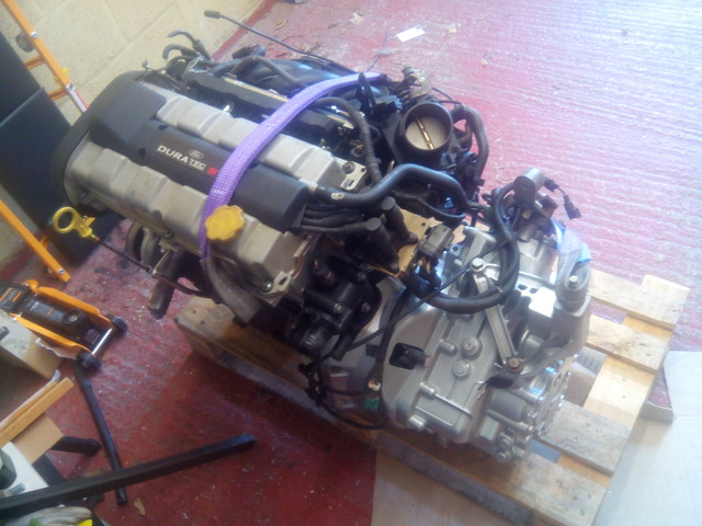

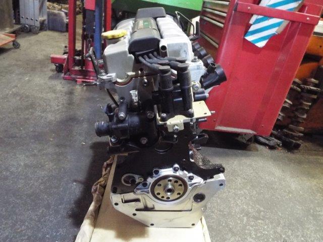

engine and gearbox were all rusted so I sent to rebuild
after rebuilt
after rebuilt
this is a photo after rebuilt - I haven't seem it in person!!
looks good!
looks good!
but it does look good!

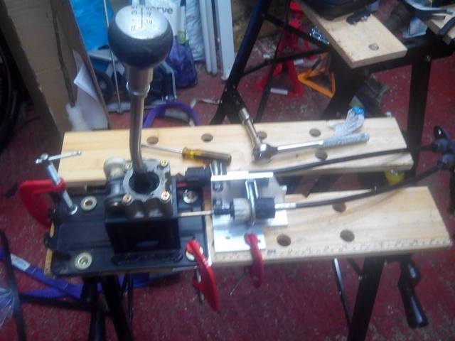

gear stick
gear stick
meanwhile sorting out the gear stick

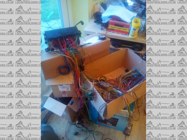

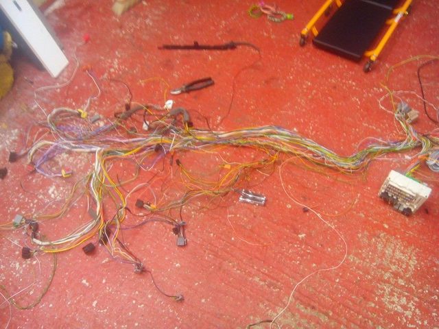

internal loom
internal loom
under-the-dash loom
loom almost sorted
loom almost sorted
plus the engine bay loom

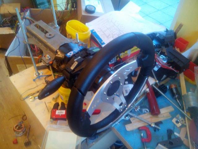

steering (obviously!)
and steering with quick-release

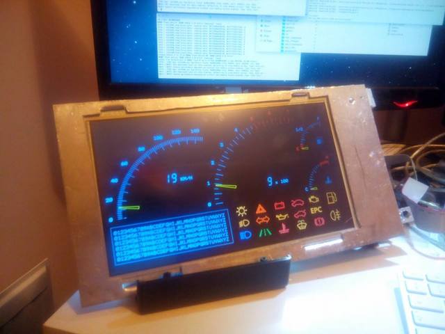

glass-cockpit 1
glass-cockpit 1
this is a mock-up of the instruments. it's an old photo, things progressed a lot!

I'm going to use the engine with everything standard. I took from the donor gearbox, radiator, everything that was not terribly rusted. I'm going to use the 6-speed gearbox - it will hurt a bit starting from the driveshafts...it's specific for the gearbox. That means I will use original flywheel, clutch, etc., original ECU, I'm even thinking of putting charcoal canister!

Good stuff, How have you made the instrument panel, is that all programmed yourself for the layout using the OBDII data?

Yeah, I'm planning to use OBD2 via ELM327 for RPM, speed, odometer and water temp. The board is right behind the lcd! I found in another forum how to read the odometer via OBD2 and apparently is valid only for Ford. Once I have the wiring done I will check if it works. As a plan B I've got a circuit with couple of hall sensors and op amps to replace OBD2.
I wrote myself the software to make the layout. I'm a little worried about the size of the LCD (10 inch) might be a bit too big to see by the steering wheel.

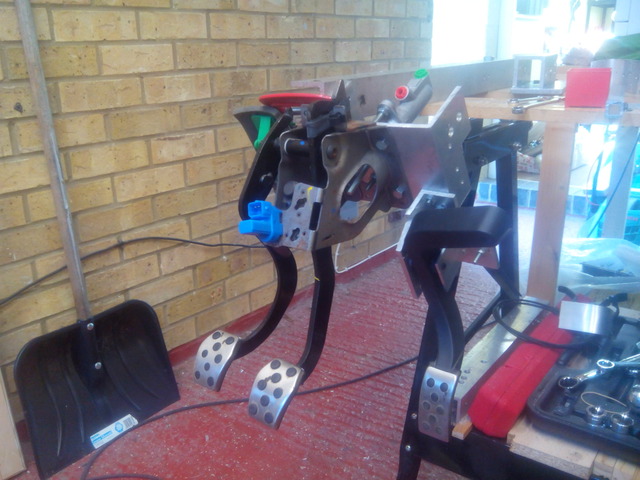

making the pedal block and save £250

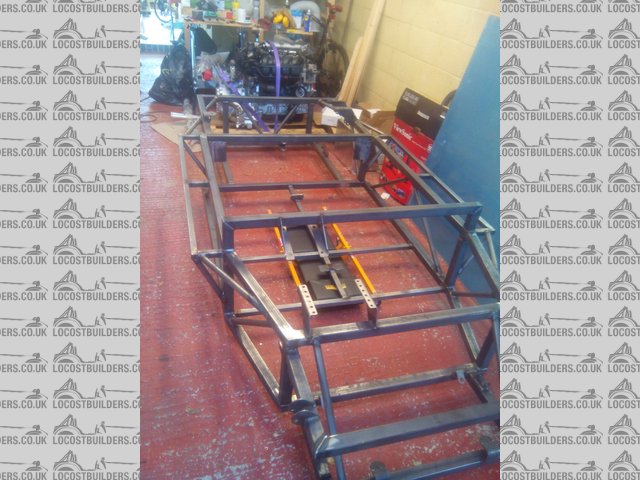

Finally I got my engine!
and this is the chassis

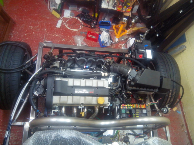

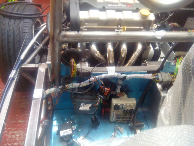

While waiting for parts and the beginning of the month (to get the salary!), I was sorting out the loom. Before I got the chassis I planned to make the loom in one way, after I got the chassis I decided to do in a different way. Result: lots of headache. I can't say the loom is sorted now, still a few pending things.
I plugged ODB2 and everything seems to be all right. I didn't start the engine yet because radiator is not fitted. I'm waiting for some tubes to bolt onto the chassis. I hope I can get cooling pipes this month. (getting short in ££ because of disc brakes!!). So far I ran the engine in the starter to pump oil a couple of times, things looked good.
Nice and shiny Keskin wheels

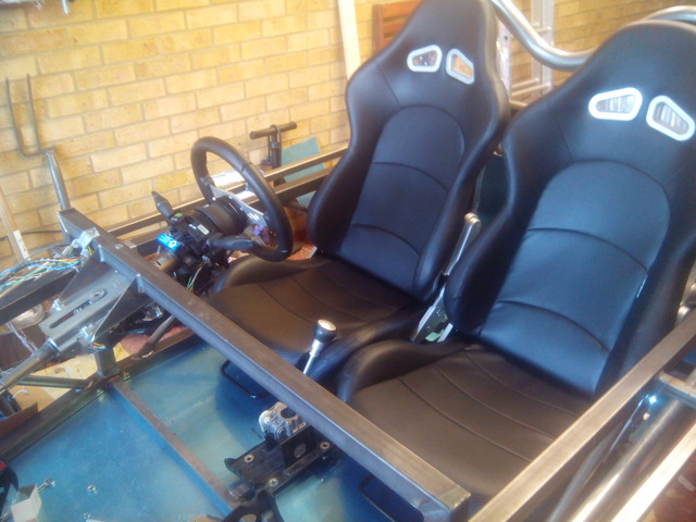

Seats bolted
Recent photos, I took them today
One of fuse box, ECU and fuel pump controller are behind the driver's seat. Fuel tank behind the passenger. I will use conduit to hide all wires. By the way, I still had to modify the chassis...there was no space for the exhaust manifold. I will also replace the bulkhead, I'm waiting for sheets to arrive.
No, I'm not going to use this air filter!! It's in there just to keep the intake manifold clean. I'm also going to put a bar to hold the fuel line, loom and the EVAP canister purge. Yes, I have charcoal canister!
Because I had the modify the rear part of the chassis, I rose the bar where the steering column is bolted. My knee was catching the steering column so I was afraid to get an IVA fail because of that. It's more comfortable though!
It's missing one wheel because I sent the upright to HiSpec. Trying to save money I got RD upright (Cortina geometry) but only accepts Wilwood callipers (expensive) and solid disc (not too good). HiSpec said they have vented discs with 27mm height and Cortina PCD and calliper with 129mm fitting (their calliper is 130mm, 129 is Wilwood) so I sent them the upright to make sure things will fit. Unfortunately discs are going to cost a lot...

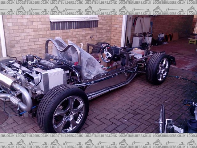

still in progress!
It's been a while I don't post any photos...

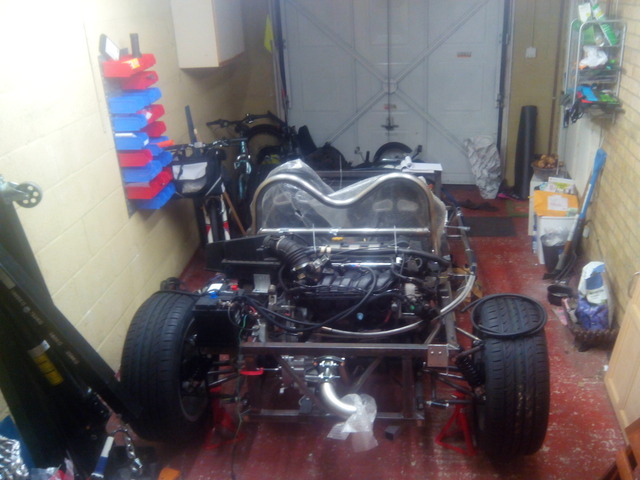

At the moment that's how the build looks like:

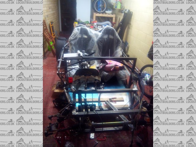

out 001
out 001
I had a hell of work with the loom. Some bits need to be sorted: tank, cooling pipe catching the far-side front wheel...then it's going to be the bodywork!
