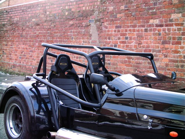

I can however offer you the one we do for the Westfields which is fully fitted ( welded not bolt on ) with side protection if required fully FIA certificated to the very latest standards ( no others available meet the very latest standards ) drive in drive out fully finished 900. U2U me if i can help in any way.
[img] Westfield with the full procomp cage fitted.

The only problem with your cage that i can foresee is me getting in and out as i have a Prolapsed Disc, and the side bar could be an issue (you may ask, why the bloody hell have you got such a stupid car then?.....)

However as you are suffering with back problems what we can do is modify the cage so that it will make life easier for you to enter and exit the car. This will take the cage away from being fully FIA certificated but will however be made to be fully MSA compliant. That will keep the added value when you come to move the car on at a later date and will make it as easy as possible for you to gain entry.

Completely off topic hijack sorry, but anyone know what mirrors they are on that car? Can't see bugger all through my racetech ones and they dont look too bad for bigger mirrors...

The cage in full FIA guise can be fitted to any of the Locost chassis that are close to the original book or Westfield desihn. Weight wise it comes in at 21 -23 Kg depending upon side protection requirements.
The mirrors on the car pictured are the ones that Westfield use.
