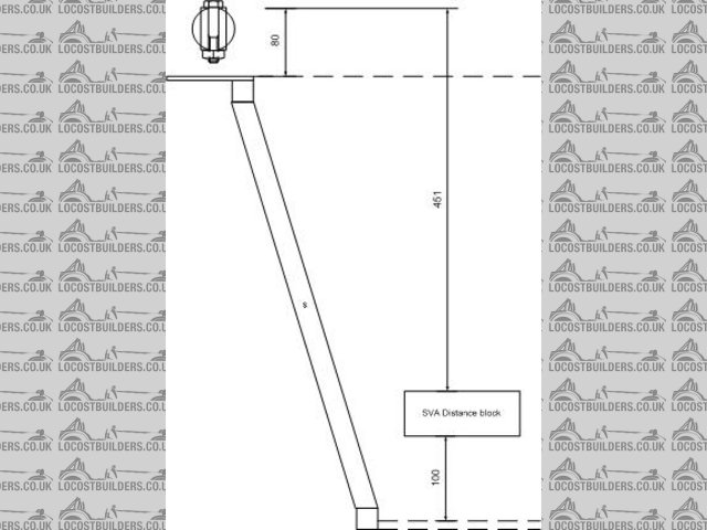

I'm just in the planning stages of making the upper harness mountings. My seats don't have harness holes so the effective mounting rules don't apply and the measurments will be from the belt mounting point rather than the seat.
Looking at the chassis dimensions, in particular K4, the top tube "O" would be the correct place to place the upper mountings only if you have no seats at all.
In the diagram below I've approximated my seat base and I would need the mounting to be at least 80mm above tube "O". This is a large amount to make up be having mountings attached to tube "O" so I propose to install a horizontal bar low down on the roll bar with either tubes or threaded portions welded in. The diagram below shows the issue with cross section of the proposed mountings.
Anybody have any comments? The roll bar is bolted to the chassis, is this an issue? Even if I thread the tubes for mounting the belts to I was going to add a Nylock on the bottom for extra security - good idea or overkill?
thanks

apart from the rollbar being bolted, what you propose sounds exactly like the way luego do it - extra horizontal tube welded between rollbar uprights at appropriate height with threaded tube welded in.

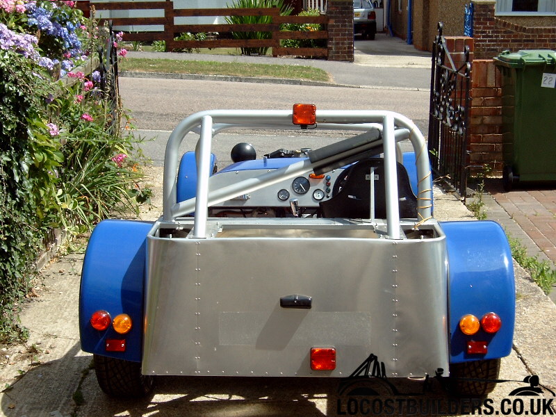

You want a bar across as shown HERE as shown on the late lamented Tangerine Dream

Jumpy Guy I've seen it done like that so you should be ok.
Dave, I think you would be ok to do as you say from a srength point of view but would it be high enough as the straps cant slope down to the mount behind the seats. They have to be level or slope up to the mount.

From you photo of the tangerine dream, it looks like your roll bar was bolted on. Did it pass SVA like this?

Andy, I should point out that this is not my car, it's the Plastic Tank Man's, but yes it did pass the sva in this configuration.

I popped into Southampton SVA centre to ask about this today.
Had a good chat with 5 different inspections officers all of whom seemed interested and sought the opinion of another, adding to the crowd and giving opinions plus scribbling on my printout of the photo from my archive.
No definitives but I was basically left with two options:
1: Mount the upper mountings on simple "n" shaped ERW bulkhead extensions AND triangulate these with ERW fore and aft!
- yeah right!.
OR
2: Cut off my diagonal rear cage bracing and fit a horizontal replacment (as with the "Tangerine Dream" picture).
Brutal - but I guess this is my only option.
It was made explicit that the way they interpret the rules, if the belts go through seat slots the whole seat is tested for strength as if it was the main chassis mounting for the belts
Unless - The belt passes horizontally through the seat slot relieving the seat of the load. They said to mount the cross bar at the height that has the eye bolts level with the slots.
And use crush tubes?
And I have to get a letter to prove the grade of the eyebolts - Feckit. FFS
Plus the usual caveat "....of course we'd have to see it 1st none of this is gospel."
