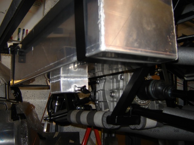

Hi guys,
I now have my alloy tank etc. It has a 8mm fuel outlet. I have found a 8mm in 8mm out pre filter too.
What fuel pump can I use that's 8mm in, 8mm out to feed a 2.0l silver top zetec on original injectors?
Cheers!

The tank I have has a sump. Just an 8mm pipe out lol
