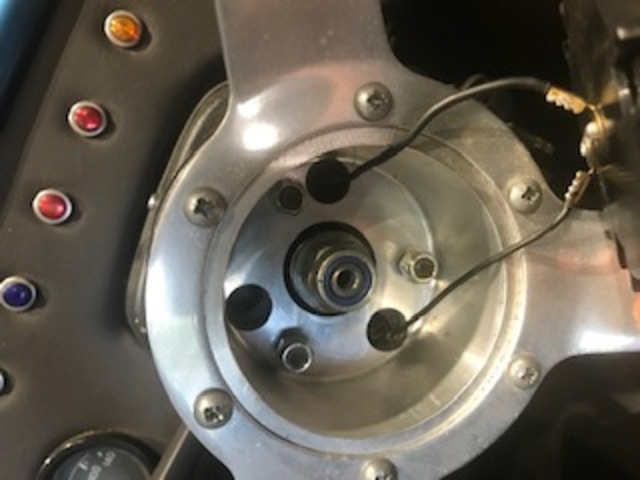

Has anyone got a photo of what the steering column looks like without a steering wheel or boss attached.
The boss on my tiger is completely stuck and I canít work out how to get it off. Usually I end up wrecking things when it turns out to be a simple fix.
Itís currently got a billet aluminium boss. Possibly made by the previous owner. Iíll try and get some photos up.

The centre nut doesn't appear to be doing much. I original thought the 3 studs were holding the boss on, but even once the nuts are removed its rock solid.
I assume the boss is splined? but doesn't look like it from inside as far as I can see.
Any ideas on the best way to remove it?

What I mean is the centre of the aluminium boss just appears to have a hole in it that the column comes through. It doesnít appear the centre hole is actually connected to the splines.
It looks more like the 3 studs are whatís holding the boss in place.
Are those 3 studs normal on a standard Sierra column?

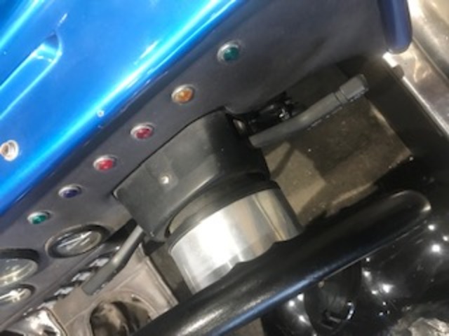

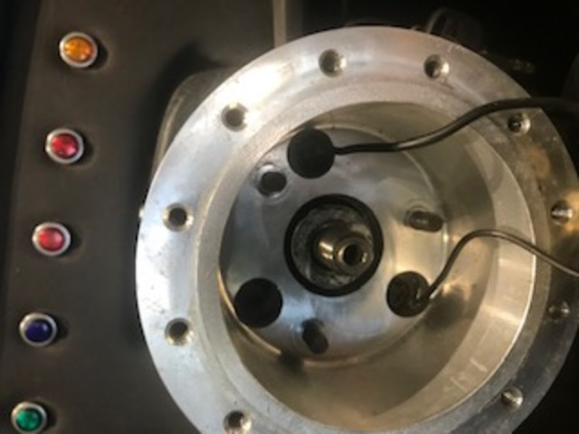

Thanks guys. Has anyone got a photo of the column without the Aluminium spacer on but with the black metal back still in place.
There is no way its pulling off by hand. And no where to really attach hub puller, I still don't think the hub puller would remove anyway.
Only options I can see at the minute is cut it off with an angle grinder (hence need the photo to see where I can cut) or replace the column.
Anyone got a spare column available?

This is starting to make sense to me now. I thought the black part was part of the column. But from the photo below I now think is a Mountney part. It seems the 3 studs are part off the Mountney black boss and the Aluminium is just something the builder made as a spacer.
So if I bolt the 3 small nuts back on and get a puller behind the black boss it may work. Kind of explains why the Aluminium boss doesn't appear to connect to the centre bolt.
I wouldn't mind but changing the steering wheel is only due to changing the seats.
