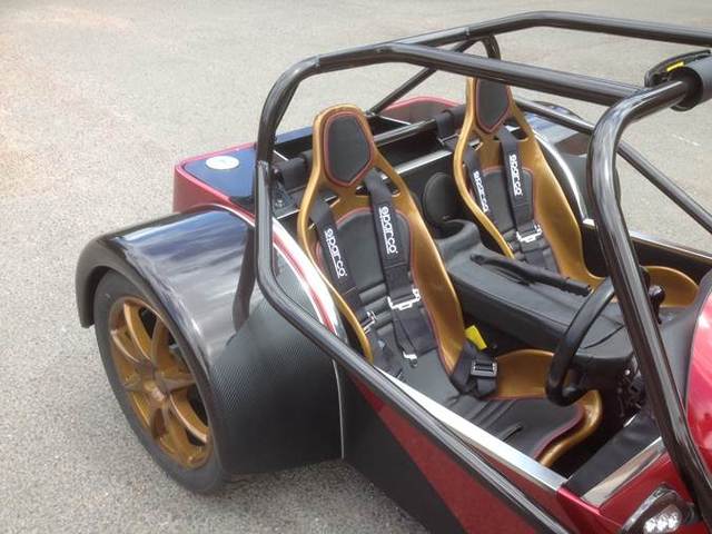

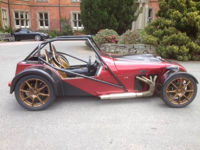

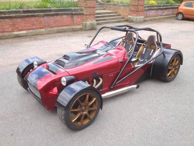

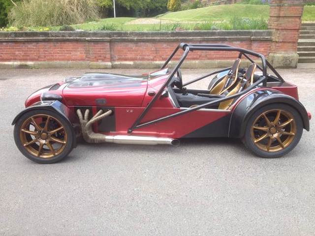

Well its taken me a year and a half of weekends and evenings to build the car from start to finish. I have done everything myself, all fabrication from rollcage, bodywork fibreglass vents to painting etc and as its my first go I am chuffed with the results!
Got my test on Monday 8th June so please let me know if I have any areas for concern. Cant wait to get it on the road and see whats its really like. Weight distribution is dead on 50/50 which was a complete stroke of luck! (not posted photos before so hope this works)

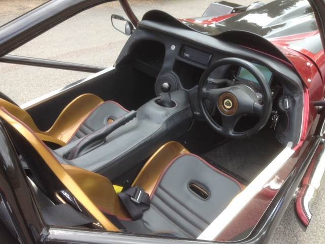

Yes I made the dash and tunnel. Used a block of modelling foam to form it and then glad in fibreglass, then cushioning and carbon fibre upholstery.
Do you mean using them as front indicators because the headlights also have a ring of forward facing LED indicator lights built in.
