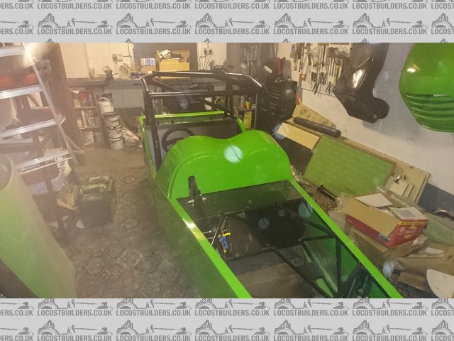

After the help of family to mount the main tub, I trial-fit the scuttle into position. It needed a little fettling to one side because I'd obviously got a slight misalignment whilst trial fitting.
ScuttleTrial
ScuttleTrial

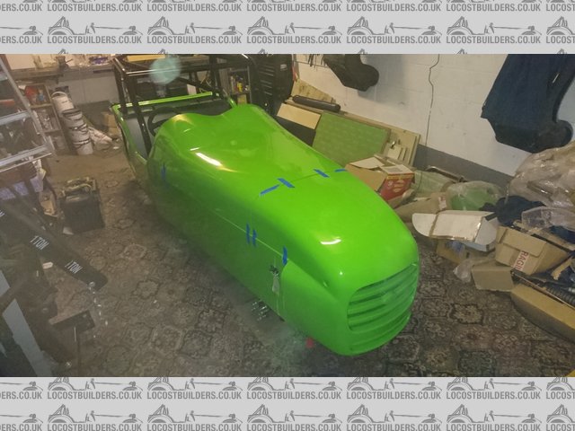

And the rest of the bodywork got a trial fit to ensure the main tub was properly aligned.
FullTrial
FullTrial

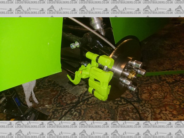

I didn't fancy rebuilding calipers myself, and I wanted a high-quality finish in keeping with the colour scheme, so I had Bigg Red rebuild the calipers and apply their green polymer paint to them.
BiggRedFront
BiggRedFront
And the rear. To anyone reading this blog, please note that the brake hose routing shown here is wrong. I corrected it just before mounting the wheels.

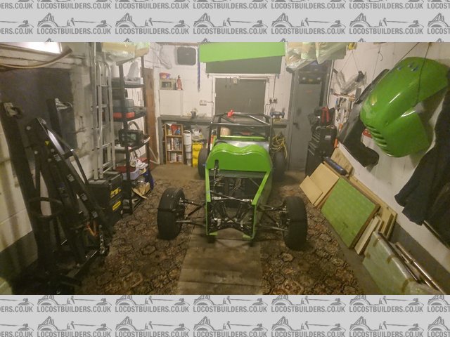

And then.... TOUCHDOWN! She stands on her own four wheels for the very first time, and in that instant transforms from a bag of bits to a car.
TOUCHDOWN
TOUCHDOWN
Having had pretty much every tool out, and with the garage floor covered in fibreglass, I had to have a thorough tidy up. The remaining parts are either the bits of bodywork hanging up, or limited to just one pile of boxes under my workbench. This is also the first time in two years I have been able to access my inspection pit.
TouchdownTidyUp
TouchdownTidyUp
Getting the car on its wheels is an important milestone. I need to temporarily evict her from the garage for a day so I can do a major service on the daily driver.
