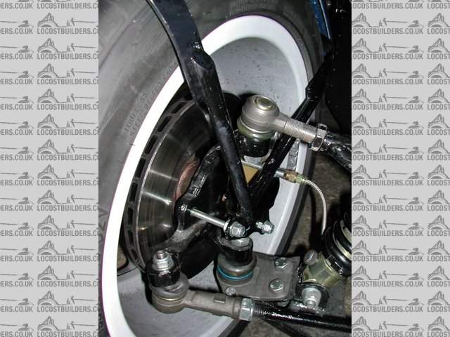

The cycle wing brackets designed for the Cortina Upright usually attach via the 3 x M8 (I think) Dirtshield mounting holes in the Cortina Upright.
I used some long bolts and Steel tubes to make the cycle wing bracket stand-off the upright and give the correct position for the cycle wing.
Like this....
NOT my picture but very similar

Thanks Justin, that's exactly what I am looking for.....😁😁😁
