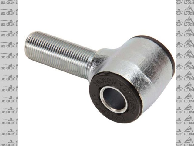

This is the sort of thing I was thinking, available in the US I wonder if somewhere in the UK makes them too.
Bush end
Bush end
