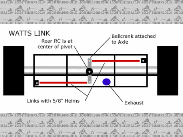

Crowley, I have tons of photos on my website. It functions like a live axle, but the diff is bolted to the frame.
Craig, Actually, I would have simply kept the Panhard had the dang thing not been going across the only place I could route the stock exhaust for my transverse mid-engine. It was either fabricate a completely custom exhaust header or use a watts link.
I am very, very close to finishing the Watts Link. I promise to post some photos of how it attaches to the DeDion and to the frame. Rescued attachment WattsLinkBala.gif

craig1410 - 3/7/03 at 10:13 PM
Steve,
That makes sense now.
Of course you can attach the watts pivot to the de-dion tube itself... Doh!
Thanks for the diagram.
Craig.
