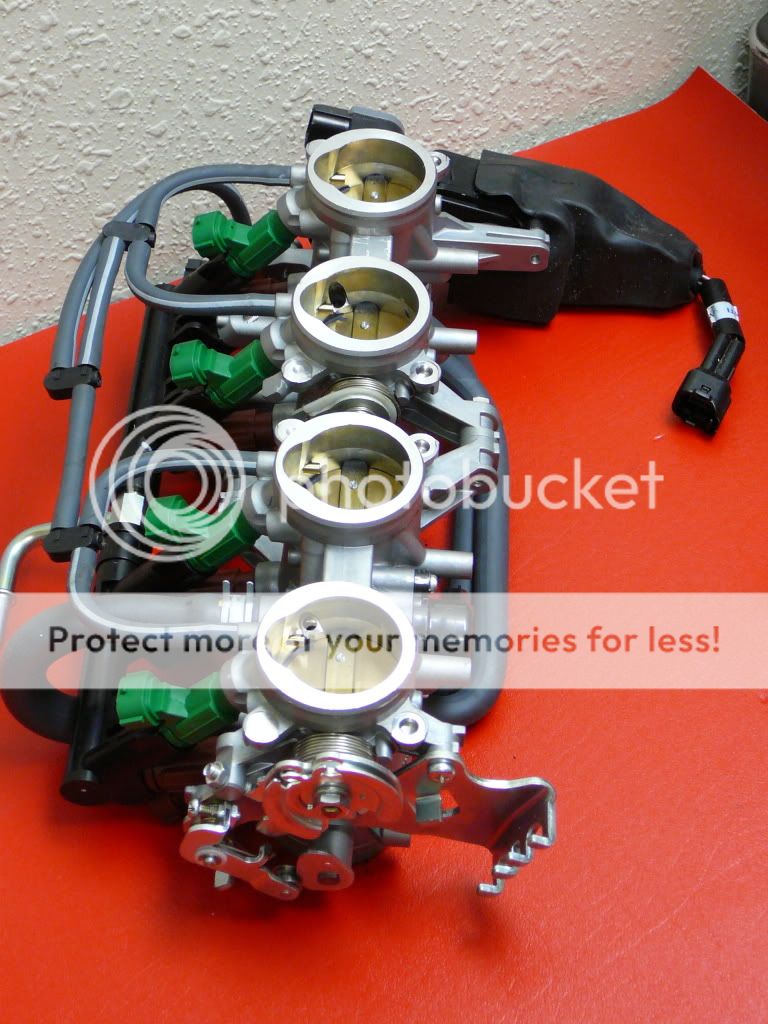

I like the idea to switch my engine to EFI and been offered GSXR600 TBs.
The look like these:

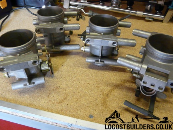

I read over the forum that they should be respaced.
But it seems there are 8 injectors. I can removed a set of 4 but I don't know the specs of them. Does anybody use these "new" GSXR
TBs?
Thank you very much!

Those particular ones are 'paired' so not individually re-spaceable. Could still be used, but not quite so easy...

Thanks guys, I know these are in pairs, but they can be easily spaced in the middle. I know it's not the best solution but the price is right
and are in great condition
As for the injectors, I don't know the specs of each bank, are the 8 injectors the same?? Seems not.
Thanks again.

I see no reason why you cant just leave the secondary set unused.If Im not mistaken,the secondary set of injectors are for part throttle..a bit like a
twin choke carb. Get a set of 4 to match your engine spec and job is a gud un!
