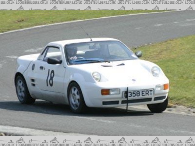

Me !
1) Roof has no gutters as standard, needs modified to fit gutters to keep it dry. Use inverted pvc bath seal.
2) Standard handbrake is cack. Modify to use Rover 200 IIRC.
3) Body is more rigid with roof on - that's why I have it on in the pic above.
4) Bleeding the cooling system is tricky, but not impossible.
5) Not huge inside, but I'm 6'2" and fit reasonably well.
4) Traction is mega. My 64ft times were comparable with much more powerful cars. After that, they buggered off.
5) Very sensitive to geometry. Rear toe settings make the car a killer or a pussycat.
That's all I can think of right now.
I recommend the K3 - K for K series, incidentally.
