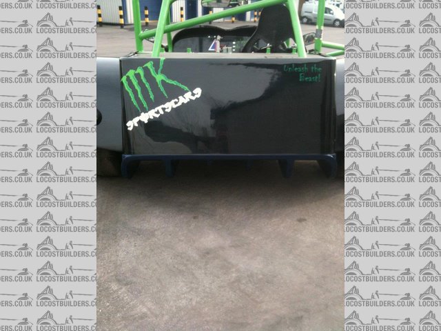

MK sell a diffuser for the Indy, also fits other locosts, its designed to fit and clear the suspension on full droop, so will not come in contact with the suspension if fitted correctly, Ive got one for my Aries, Ive not got round to fitting it yet due to the crap weather, so no pictures of it fitted to mine, but this is it on a Indy.
[img] Description
[/img]
