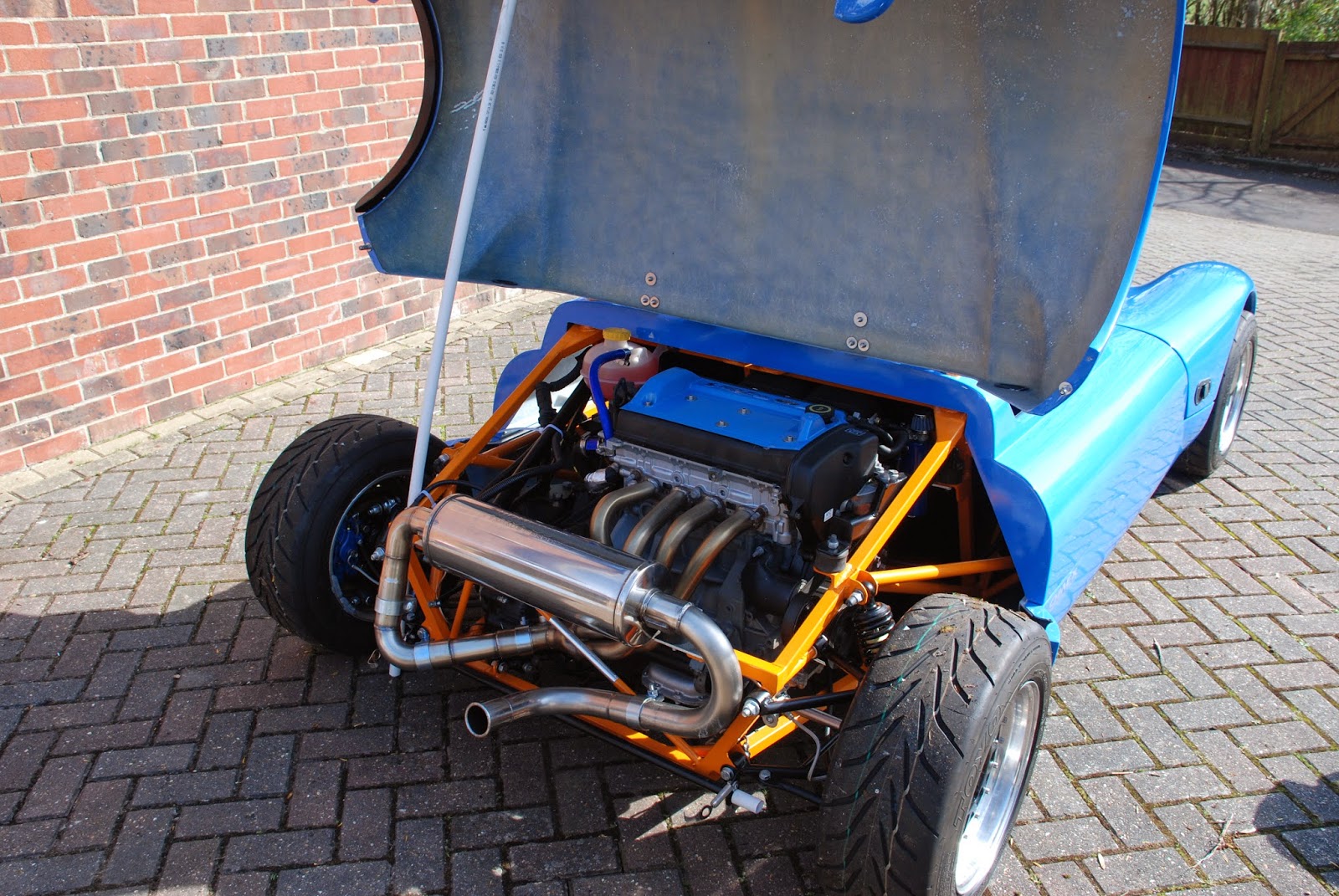

Hi Nick,
Have a look at my photo archive and see if theres any thing useful in there. My Boot opens about 15 inches which is more than enough access for day to day stuff.
I have also made to easily removable with a multi connector for the electrics and 5 easily accessable bolts.
Only takes about 10 minutes to take the whole thing off.

I had this problem too. My rear clam only opens about 4 or 5 inches "just" enough to check oil and water (needs a funnel to top up though)
I made my exhaust as low as the chassis and trimmed around the can, so the exhaust tip is the stopping point
But I too have a multiplug and 4 M6s and the clam is off
