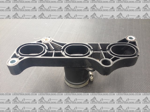

I'm trying to make a (very) locost set of throttle bodies.
The first pic shows the donors plastic inlet flange which I plan to take a drawing from. I'll get an ally flange cut from the drawing
It also shows one of the TB boots.
Plan is to get holes drilled and tapped in the flange to take these boots.

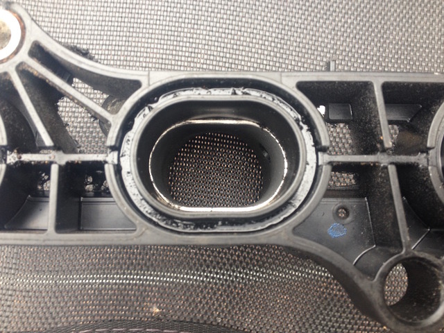

As you can see in the bottom picture, the boot port is fractionally smaller than the engine inlet port. The pic makes it look worse than it is... I'd say it's out by 1mm on the top and bottom vertical plane (each side) and 0.5mm's at either side of the horizontal plane (each side).
Sooooooooooo...
Is it likely that the small 'step' will disturb the air flow to a noticeable level?
Is it worth me porting-out the boot a little to match the flange port?

Genuinely don't think you'll notice it without hours on a dyno and back to back variation.
Some designers use step-up's like this to reduce flow reversion. I think the key questions is "is the boot big enough for the flow you expect"? If yes, the step out will be fine.

I made my own set of trumpets for my 4 age.
I did a fair bit of reading and one of the things i read was that little steps are often used to make the air tumble. This actually helps fuel mix and is designed in.
If its forced induction all of this makes little difference

You really don't want tumble before the valve as you choke flow through it. You want tumble initiated at the valve so you get full flow through and better dispersion afterwards. The steps are used as antireversion though. That step is too small to affect anything in reality.

Which way is the air flowing? if it flows against the step there will be airflow disruption, the other way will be fine.
Never under estimate the ingenuity of an idiot!
posted on 3/9/15 at 12:27 PM Reply With Quote
The air is flowing 'down' the step.

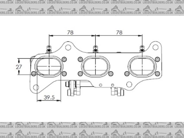

This is my inlet port diameters...
I eventually went for the Triumph Speed Four TB's which are also seperable. A bit too small (obviously), but they're going onto a 3 cylinder 1.0 engine, so will still be capable of flowing far more air than the engine will ever need (within my budget!).
The other benefit of the Speed Four TB's is that they don't have injector apertures, so I can use the existing injector apertures in the cylinder head.
Oh, and I get to keep one TB as a spare!
