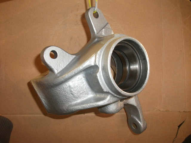

That is Rust Bullet on the inner arch of my old Evo.
One thing with Rust Bullet is you must use two coats,so can take a bit more time.
They sell a acid etch/rust removal spray too to wipe over the metal,Metal Blast

CosKev3
posted on 24/2/16 at 09:35 AM Reply With Quote
It is only available in silver yeah,you can use it on its own,if you want a sliver finish!
I used it on to bare metal,then seam sealed the shell,then top coated it on Evo.
If your painting over it it needs to be done within 48hrs iirc,if it's after its gone off totally you need to rough up the surface for the top coat to take.
It is unbelievably hard once it's gone off,and if it chips it won't peel or lift letting water under it.
CosKev3
posted on 24/2/16 at 09:37 AM Reply With Quote
Used it on my sierra hubs for kit car,then finished them in satin black.
