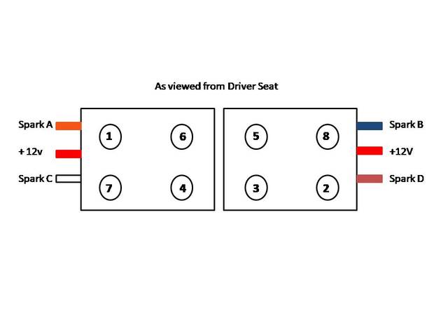

Which coils are you running in what combination wasted spark individual ( need more info here ) They are the THOR coils, 2 x 2 wasted spark, similar to the ford 4 cyl coils. Driven directly from the ms, its an extraefi unit from Phil.
what advance are you running at tickover and while accelerating have you had a timing light on it and seeing the advance when you hit loud pedal, Iíve tried anything between 10 an 20 degrees, yes I can see the marks advance with the light...
Plug leads so easy to get wrong ( been their got the tee-shirt ), Iím sure theyíre right, but worth another check.
Wired like this

Ok Pete look like the obvious on the spark side is covered and it's timed up ok.
While ticking over pulling a lead with insulated pliers should change engine note if one does not could indicate an issue but here again a discoloured plug would also indicate an issue so maybe move on for now
A few further things to cross off good clean 12v seen on coil feeds, injector feeds and ecu at tick over and while reving up ?
