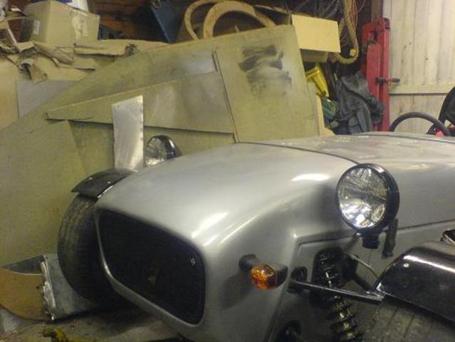

I went the other way and widened my nose cone by 1"
[Edited on 25/11/18 by mark chandler]
