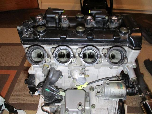

Simply add engine mounts to your chassis (or adapt the ones you've got) and fit this?

Whatís the power output of the gixxer?

This engine package will sadly not meet the criteria, it's only 188.0 BHP at 11,323 rpm, 96.4 lb/ft at 8776 rpm.
Mike really needs to look at the latest Kawasaki ZX10 (or at least beyond the 2011 revision), or a late model BMW 1000rr. The former is somewhat more affordable, both have electrical issues that really warrant aftermarket ECUs. GSXR1000, late models, or a K8 (preferably bored to 1070/1080, a favourite of the hillclimb brigade) could also be a solution. Standard K8 ECU can be romraided for tuning/device/sensor elimination which saves a some money, if that's important.
