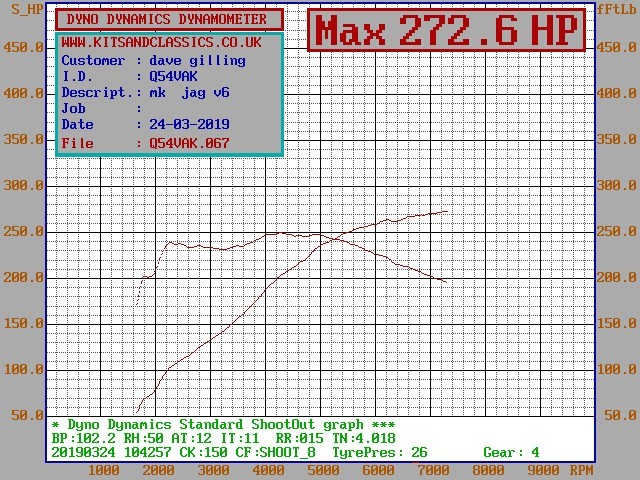

I used a MS2 extra, it worked very well Standard AJ30 with ST200 inlet and 65mm TB.
After VVT adjustment

Not really. I know of one guy with a rocketeer who has a dyno print of 290 on the mbe ecu. Some are 260 270.
Kev can probably give a more accurate answer but am sure his 3 dyno runs have had a 40+bhp swing, same car different dynos. Dyno figures are only good for back to back runs to make upgrades and comparisons.
Although yes I do agree the st200 Inlet seems to be a sweet spot. The huge runner length is obviously a good match. Even the 2.5k jenvey kits only give moderate gains on the couple of figures I've seen.

Yeah ref RR's the way different people operate them and work out the figures from wheel to crank etc varies massively!
Every RR you go to swear their RR is bang on and more accurate than any other.......
Mines varied by 40bhp as Steve says,the lowest being calculated at 230bhp on a RR where the operator ran it in some sort of strange stepped set up,on another more modern one it did 240bhp.
It would be interesting to see the results from a power run on Dales RR?
You didn't accidentally fit a 2.5 replacement did you????
