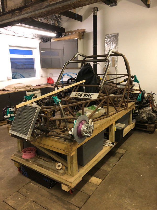

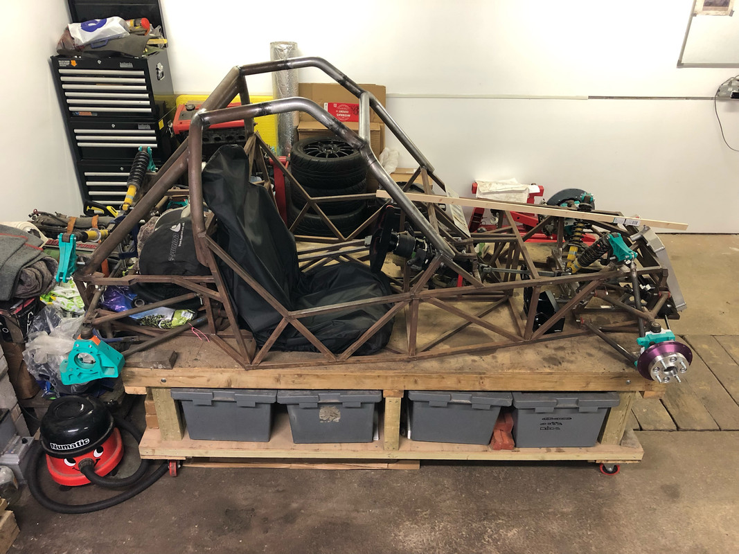

Hi guys, havenít posted in a while and Iíve had limited workshop time last few months but over the last two months have made some progress. Still a mix of partial welded and mock up, but I am hoping to get the car off the table in a month or so and actually sit in it on its own wheels for the first time ever!

Originally I based the design on cortina mk5 front hubs and fiat coupe 20vt front hubs for the rear. But these were modified extensively and after many iterations (search my user Iíd) I ended up deciding Iíd rather make my own.
The rears are based on Lotus Elise series 1, but made to suite my design. These will eventually be machined, the green parts you see in my photos are the latest iterations. They are 3D printed, Iíve done all the work myself. I have used the fiat coupe hub flange so my drive shafts match, but found Audi A4 bearings, a bolt on item were almost the same size, a little lathe work will see it all work. Iím running a fiat coupe 16v turbo vented 283mm disc on the rear and have some vauxhall omega twin pots to mount for rear brakes.
The front has evolved from the cortina set up, basically there were several things I didnít like about the old ford set up and I needed to do a far bit of work to overhaul them, so again designed my own, the upright is my own design which uses the original ford upper and lower ball joints. I hated the way the cortina disc mounted on the rear of the hub and always intended to run the fiat brakes, with large discs, so this was always a problem. Iíve ended up using a Fiesta mk 7 rear hub bearing (again bolt on) which allows my escort cosworth group n bells to fit. Iím going to mount a 320mm disc to the bell (the disc is a printed mock up) and the new upright has the correct caliper mountings. The 320mm disc clears my 16Ē team dynamic pro race 1.2s with around 4mm of clearance, was a right job developing that, but I am pleased with it.
Youíll note spacers, the rears uses a PCD adaptor to convert the fiat 4x98 to ford 4x108 and the fiat disc is sandwiched between hub flange and spacer. My rear wheels are 17Ē x9j with a big off set, so plenty of space.
The front has a 25mm spacer, this was to clear the Brembo caliper off the rim ridge on the inside but also with the alloy cosworth bells - the fiesta studs were a bit on the sort side, this set up works a treat.
Final track to wheel base will be spot on 1:1.6, I am running 16/45/225 front and 17/40/255 tyres.

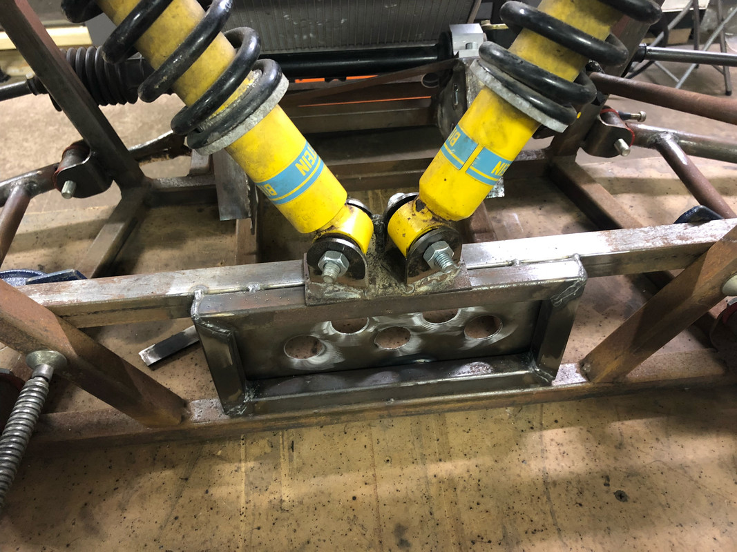

I always wanted inboard suspension, the main reason is for adjustability, I have more control over the ride height this way, and will corner weight it eventually, currently planning on using Lotus Elise S2 Bilsteins and on the rear a VX220 turbo rear anti roll bar. I am planning on making my own front anti roll bar, but I havenít figured that out yet. Plenty of Lotus upgrades at a later stage.

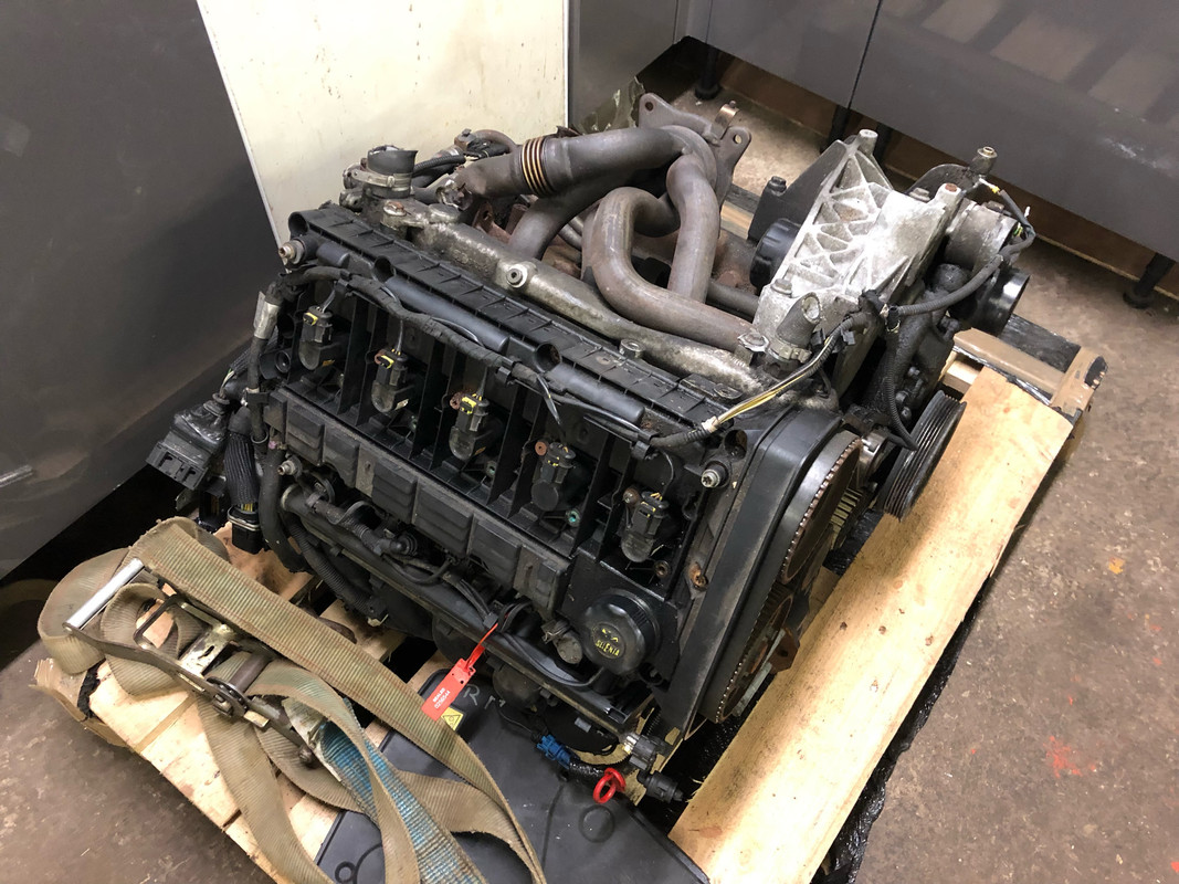

The plan is over the next couple of months to print the final rear hub carrier and finish the welding of all the components on the suspension, from there Iím going to set the car on the ground for the very first time on its own wheels and see what it looks like. I had the engine in last year, one of my 3D printed hubs supported the weight of the engine and gear box, so I am confident for rolling chassis the hubs will be strong enough. This year once itís a full rolling chassis Iím going to get the engine finally fitted and get it running. I have a 1000kg scale for my lifting beam, so will be interesting to see what it all weighs. I have two full engines, wanted to build a 2.4 20vt but canít find a complete bottom end to play with, figuring Iíll stick with 2.0 for now.
Hope thatís useful, I know there will be many differing views on my set up choice, but my outlook on this project is I just love the challenge of the engineering and prefer to do my own thing with it. Body work is going to be full carbon, canít wait to start making that!
