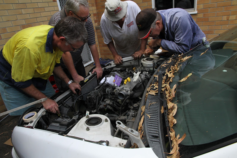

So, the day for "Gutting the Corolla" was Saturday and here's a few pictures of what went on, courtesy of my wife and her camera. Special mention to for allowing me to pull a car apart in our driveway, with a gang of mates, on our wedding anniversary
Probably more clubbies than our sleepy cul-de-sac is used to (there were two more but Leanne only grabbed this shot)
Mechanical geniuses discuss options:
You can never have too many people standing and watching
Well don't all just stand there! Drink something!
The slightly reluctant captive is released from it's boring prison
