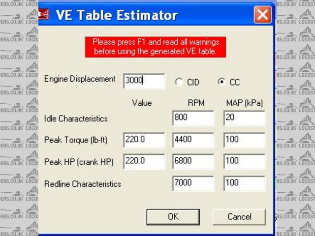

mark chandler
posted on 12/5/08 at 10:14 PM Reply With Quote
If its a 3litre then try this: Rescued attachment claire.JPG
clairetoo
posted on 12/5/08 at 10:15 PM Reply With Quote
tried that - it says `Torque at maximum HP (122.5) is higher than at peak torque (115.0)!`
If that makes any sense to any one
Off to bed now...
Its cuz I is blond , innit
Claire xx
Will weld for food......
mark chandler
posted on 12/5/08 at 10:21 PM Reply With Quote
clairetoo
posted on 13/5/08 at 05:31 AM Reply With Quote
Um...........but as my engine isnt a 3 litre making 220bhp would the map generated work ?
