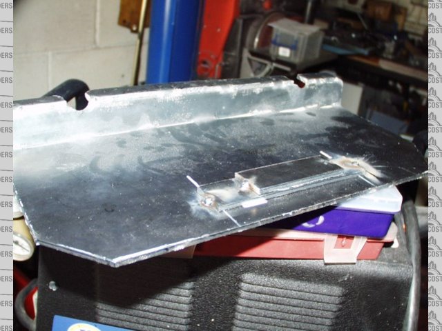

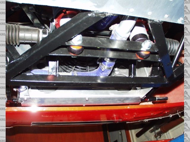

| posted on 4/4/13 at 04:34 PM |
I have knocked up this 4mm plate that fits under the front coil overs, I am going to attach an A frame made of ERW box section and a towing eye.
Comments?
[pg]97350[/pg
[pg]97351[/pg
[pg]97352[/pg
theprisioner
| posted on 4/4/13 at 04:37 PM |
Sorry images lost?
  Towing 1
  Towing 2
  Towing 3
