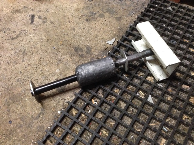

It has a Ford Escort live rear axle so it's not straight forward! First thing I needed was a slide-hammer to enable removal of the
Half-Shafts...
They're kind of hard to come by unless you want a small one for pulling dents - so I made one. It's made from some off-cuts from around
the Garage plus a sheet of 6mm thick lead I happened to have lying about. In this picture I hadn't welded it up but you can see how it was
made.

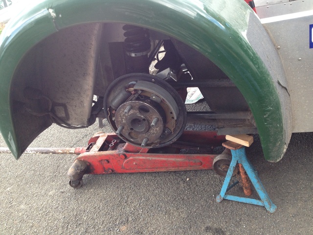

So after making the Slide Hammer I set to work this morning. I jacked the car and supported it with axle stands. Removed both road wheels and the
brake drums. Then you have to undo the 4 x M8 bolts that hold the bearing cover plate. Once they're out you can set to with the Slide Hammer.

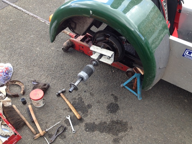

The Slide Hammer fits over 2 of the wheel mounting studs and I used the road wheel nuts to hold the Slide Hammer in place. A couple of good hard bangs
(slide the weight down the shaft away from the axle) and the shafts come loose. You then pull them from the axle casing and mop up the oil that will
spill - get ready for the Sulphur smell of the diff' oil!

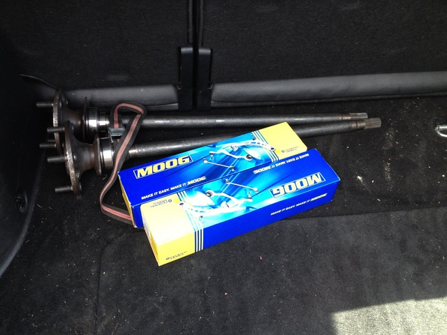

The bearings are a press-fit onto the Half-Shafts so have to be cut-off along with the retaining rings. I ordered the new bearings and retaining rings
from Burton Power, they're the ones with an O-ring on the outside of the bearing. Once the Half-Shafts were removed from the axle casing I took
them to a mates garage were he helped me press the new bearings and retaining rings into place.

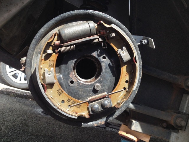

Once the new bearings and retaining rings were in place it was time to head home to clean all the brake components and rebuild both rear drumbrakes
with new shoes. This picture shows the 203mm Ford Escort drumbrake built up without the Half-Shafts in. Leaving the Half-Shafts out makes it easier to
get the shoe and springs/adjuster assembly into place.

| posted on 25/7/15 at 08:41 PM |
In the pictures of the brakes, you've got the shoes on the wrong way around. The leading/trailing edges are the wrong way and could lead to them
grabbing.
http://jpsc.org.uk/forum/
bigrich
| posted on 26/7/15 at 07:04 AM |
Thought exactly the same thing Adithorp
