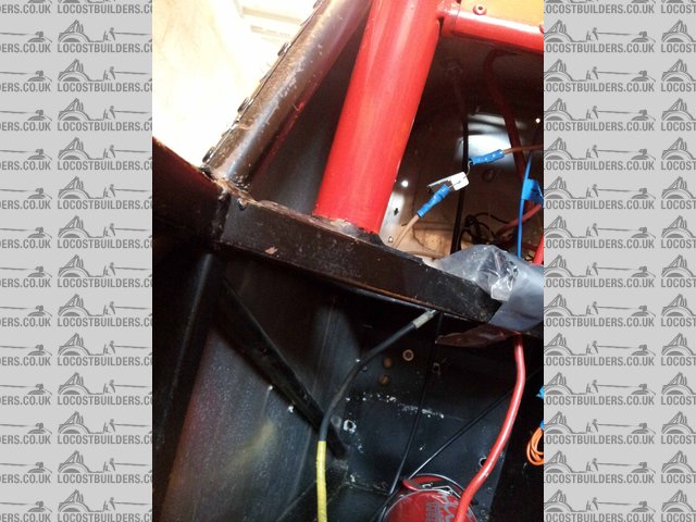

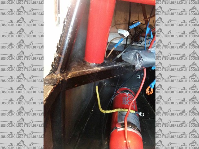

1. My main worry it the way the roll cage is mounted to the chassis. The front feet are mounted to a triangular 5mm steel plate welded to the top of
the chassis rail and bar crossing the foot well. This means the centre of the roll cage is approximately 80mm from the centre of the nearest vertical
upright. The lack of vertical support is worrying me and if, in an incident, the cross member across the footwell gives way, then it's only
going to end with crushed legs!!! The mid mounting points are done in a similar way, but the rearmost mounts are at least welded to the bottom of the
chassis. I was thinking I could add extra members to get the support (don't know how that will go down with scrutineers), or get a new front
hoop bent and professionally fitted to the cage so it mounts outside the chassis. Any ideas? Or am I being too paranoid?

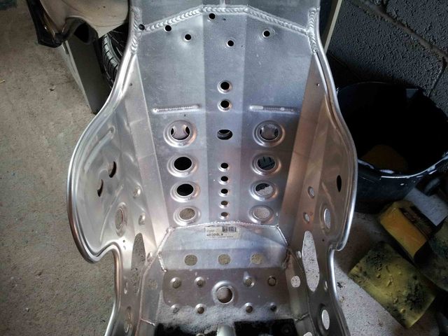

2. The seat is a Kirkey lightweight item. It looks like its been fitted to a different car previously so I have no idea how old it is. I fit in it
quite well width wise, but the rib protectors are far too high under my arms. I'd like to modify this seat as its too nice to get rid of, so has
anyone modified these as it looks difficult. I also like the Kirkey as I can get some head restraints to use with the existing seat. Otherwise, what
seats would you suggest? Custom foam seats wouldn't be great as I would like family and friends to be able to drive the car and the duck tape
covers aren't particularly nice. I'd like to IVA the car so a second matching seat may be good.

gharris333
| posted on 12/8/14 at 07:21 PM |
  Roll cage feet
  Roll cage feet 2

  Kirkey seat

You however don't need everything on day one but a process of continuous improvements should be your goal. What you are starting off with looks
safe enough but I think your own comments are valid. The seat, if it is uncomfortable, will probably cause you injury in a "big one".
However probably much safer than any GRP seat. The cage/roll bar mountings don't look that bad to me but you may need some expert comment
here.

The front roll cage mounts are similar to many cars on the grid including ours but they should really be (as stated in the blue book.) above a
vertical chassis member. I think if it were
my car I would alter it to be compliant so as not to cause safety/scrutineering issues.

As for the kirkey seat I was advised they are not really suitable for open topped spaceframe cars with stories of drivers getting trapped in their
seats after impact with the rescue crew finding extraction difficult due to the limited access to the car. I can only think of two or three drivers
on the grid that actually use them. Most use either moulded foam or Tillet style fibreglass seats.
