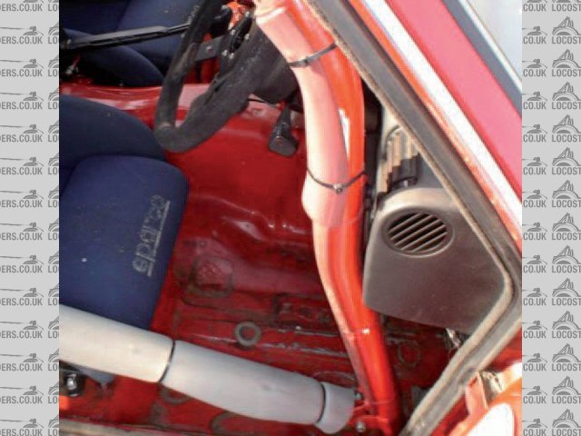

quote: Originally posted by procomp
And yes the scrutineers are cracking down on it as has been seen with the majority of MK rollcages being refused at race meetings.
Cheers Matt
Could you confirm why MKs cages dont comply? is it the style or components/finish?
as u can see from my avatar, its that style og cage i liked, and was hoping to have Raw make up
[Edited on 15/4/10 by loggyboy]

I believe the curved top longitudinals are an issue, as are the curved a pillar bars.

Cant see anything in the regs that says the 'longitudinal' or 'additional reinforcement bars' should be straight.
Anyone confirm?

8. The front leg of a front or lateral rollbar must be
straight, or if this is not possible, must follow the
windscreen pillars and have only one bend with its
lower vertical part. Where the main rollbar forms the
rear legs of a lateral rollbar (see illustration Appendix 2,
drawing 6), the connection to the lateral rollbar must be
at roof level.
Neither the front legs or the roof bars comply with the regulations hence some cars have been made to change the roll cages. They DO NOT meet the very
basic regulations.
Cheers Matt

I can completely understand the front bar, (although only one bend is clear from external pics, I'm guessing it kinks again once inside the
car). I plan to have mine running externally, at an angle running down but with no kink at all.
However I cant seen any justification behind not allow the kink in the upper bar, I cant see any mention in the regs stating it has to be straight.
Would be interesting to hear their reasoning behind it (if that is what it was being refused on aswell as the double kink in the front rollbar).
[Edited on 19/4/10 by loggyboy]

Is the MK roll cage certificated. NO. So therefore it has to comply with the FIA/MSA drawings. Do the drawings show bends in the roof bars. NO its
that simple.
Cheers Matt

The problem is that the roof bars have a limit to how much of a bend they can have. As can be seen from the picture you have posted above it is not
really a large bend. The bends that the MK rollcages have do not comply with the FIA/MSA regulations. Which is why the MSA scrutineers have excluded
at least 5 cars fitted with those cages.
If you want to take issue with the regulations then i would suggest contacting the FIA as the UK runs under FIA ROPS regulations these days not MSA
regulations. ROPS is quite a technical area of the regulations these days which is why the FIA/MSA invited all car manufacturers competing in the UK
to a ROPS meeting a few years ago. Of course non of the kitcar manufacturers bothered to turn up except one. Which is why we now have a situation
where virtually all kit car manufacturers are now fitting and supplying non compliant rollcages /roll bars for use under MSA/FIA regulations.
Cheers Matt
