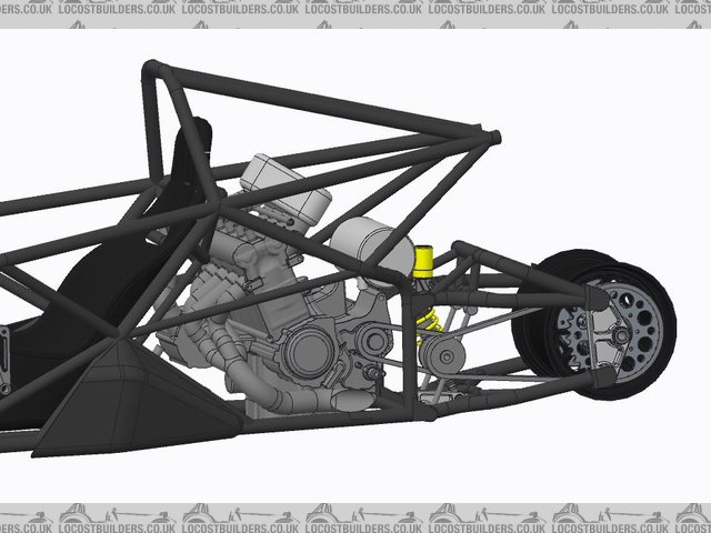

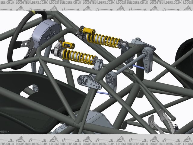

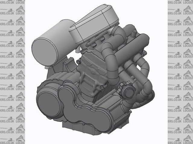

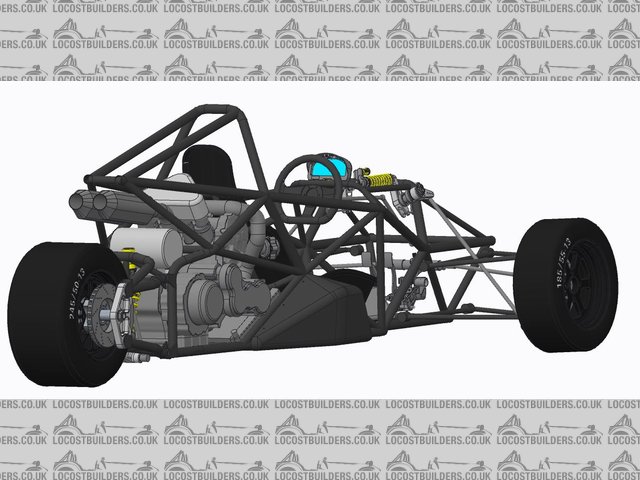

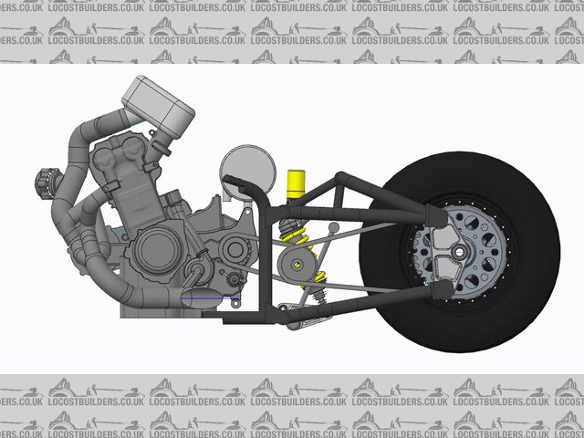

A brief update for anyone that's interested...

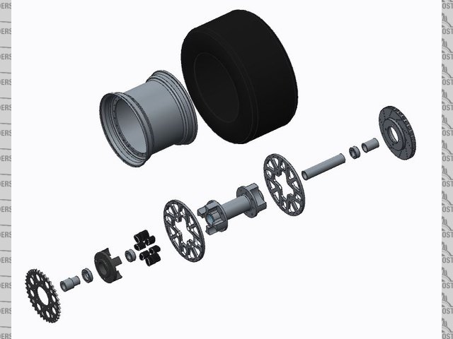

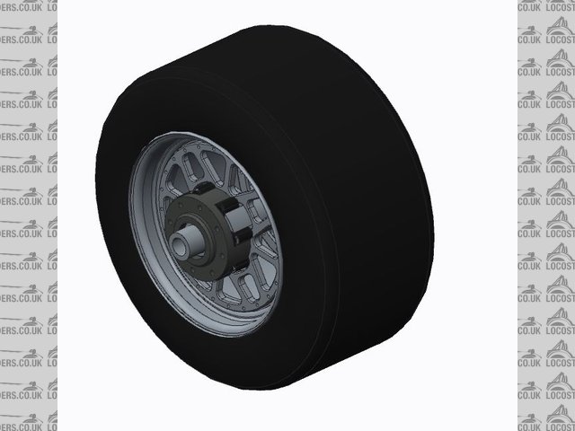

Managed to find a few evenings to start focusing in on some specific areas.
Had a stab at a bespoke 13x10.5 rear wheel using COTS parts where possible. Fairly confident the shaft/bearing arrangement works OK, although the cush
drive solution drives a bit of complexity into the design.

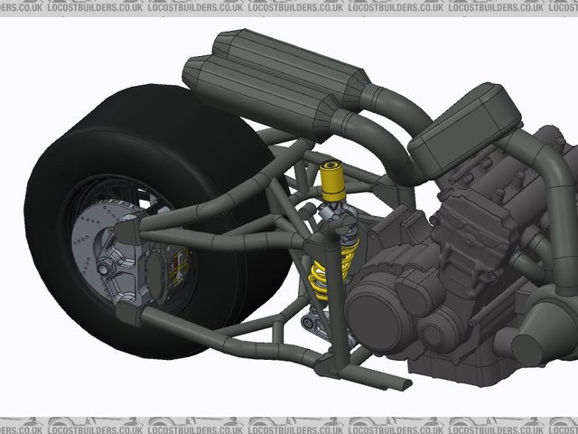

Acquired a seemingly representative model of a Powerlite caliper which I've adopted front and rear, and which packages up quite nicely at this
stage.
Also went a bit mad on a fancy front suspension linkage design with ARB that uses Hayabusa taper roller bearings, plus started playing around with
some layouts for forced induction
Next up - chain tensioning strategy and a countershaft of some description, plus need to think about oil reservoir, battery and radiator locations.

With regard to your front pushrod and ARB system, have you thought about using a third spring and a Tee ARB?
| posted on 2/3/20 at 07:34 AM |

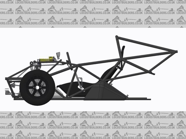

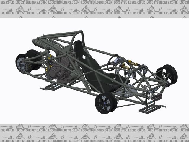

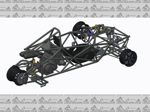

I notice you have not yet included the steering column or rack, how is that going to work? it looks like it will be coming down between your legs?? it
might be worth at some point soon mocking the cabin up out of wood etc just to check the ergonomics of it and whether it is possible to climb in and
out. I'd still like to see some steel beyond the pedals tbh, far too VW camper crumple zone for me.
I build large wooden R/C model aeroplanes and while designing them I will build many mock-up parts to see if they work the way I thought on paper.
Drawings or CAD models are all very well & good but actually having the thing in your hands so you can twist, bash or flex it can't be
beaten.
If I was you I'd get some balsa wood and build say a 12 inch model of the frame for testing. Could save you a lot of time & money later,
will also give you an idea of how much a pain all those joints are going to be
53Stix
| posted on 2/3/20 at 09:22 AM |
@Uphill Racer - My relative inexperience shines bright here as whilst I've searched far and wide for suspension architectures which meet the
design brief, my lack of experience in four wheeled vehicles means I don't have much in the way of "applied" experience to critique
them over/above perceived mass and cost.
There are some interesting benchmarks buried in the depths of the Spartan build thread...
https://reversetrikes.freeforums.net/thread/102/spartan-trik
e-project-captainamerica
...although if I understand you correctly what you're referring to is primarily a means of controlling heave rather than roll, similarly to the
setup used by Cody Loveland on his original Enviate?
@Mr Whippy - Good suggestion! Steering column and rack are visible, but hard to distinguish in the images above to be fair. Current intention is a
Narrco FSAE rack...
https://fsaeparts.com/products/narrco-racks
...but, again, that's purely on the basis of not having stumbled across anything more suitable just yet. All suggestions welcome!
An ergonomic buck is certainly high on the agenda. I think there's a small number of COTS parts that I want to procure just to get a feel for
the proportions and layout (i.e. wheels, uprights, seat, steering wheel and pedalbox) and then the first job is to lay it all out on the garage floor
and start getting a feel for all these sort of things. You're totally right that you cannot get a genuinely good understanding using CAD alone,
and I'm regularly looking at the tape measure and steel rule on my desk to understand design proportions and clearances etc.
Your earlier comments about crash structure haven't fall on deaf ears - I'm thinking that a front-mounted crash structure again akin to
FSAE designs will be very sensible... I just haven't got round to modelling it just yet.

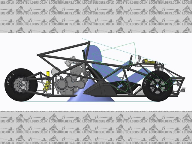

| posted on 25/3/20 at 10:00 AM |

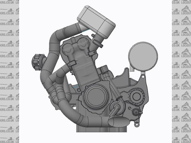

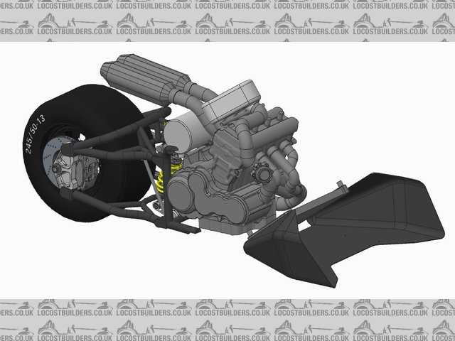

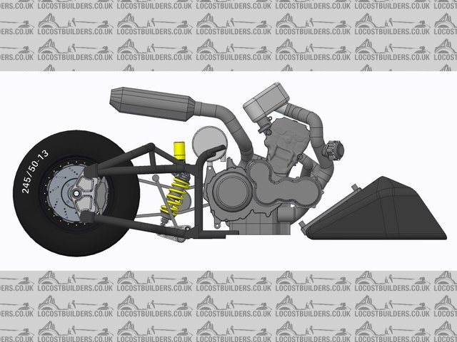

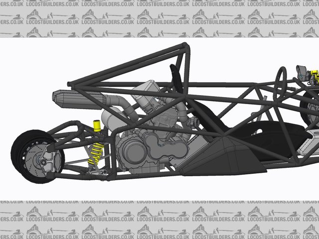

With the requirement to stay at home recently I've taken the opportunity to try and push things forward a little on the design.
Powertrain is coming along nicely. Some very positive input from Richard @ TTS has prompted the move to a supercharger which appears to package quite
nicely.
I've also modelled a simple rad and some ducting which somehow (by accident) seems to remind me of a fish or shark... I like it!
A simple slash-cut exhaust could look pretty cool...
Making good progress now

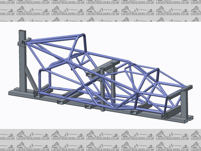

Finally starting to think about fixturing. The chassis will be a b1tch to fabricate but with only a couple of compound-bent tubes I should think
it's not beyond the realms of possibility.

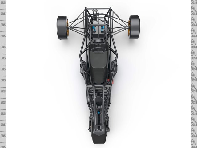

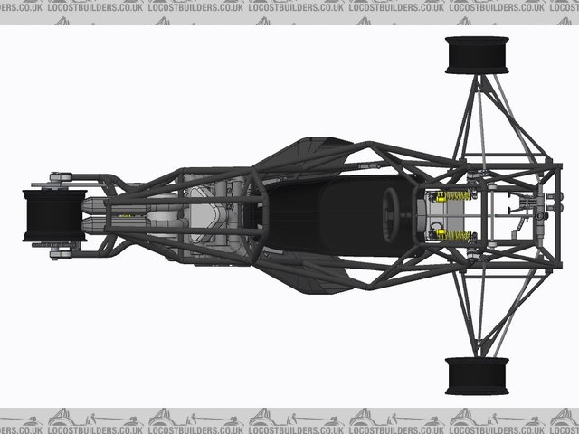

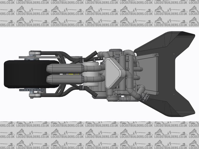

| posted on 25/3/20 at 10:32 AM |

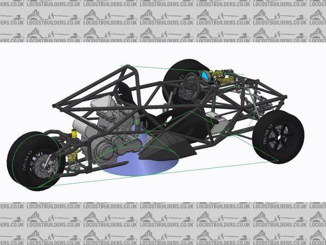

Here's a couple of shots to show the intended split for the powertrain 'module', which allows the main frame to pick up on the
cylinder head mounting lugs once installed.
And for context, this is a 95th % male in the drivers seat. Snug but hopefully sufficient. Plenty of head clearance in the event of a rollover too.
And finally, speaking of rollover, I've made an assumption for the CoG position and used this to map out the LatAcc threshold (I.e. the angle
made by the cone projecting down from the CoG).
I'm lead to believe that the angle created by the cone when it's tangential to the vehicle contact triangle is a good suggestion (AFAIK)
as to the LatAcc capabilities (i.e. the point at which you'll either roll or slide).
The wider the angle, the harder you can corner, which could be achieved by either lowering the CoG, moving the CoG forward or changing the
wheelbase/track relationship.
The trick is presumably to make sure that you slide before you roll in every scenario... easier said than done I guess!

It's worth noting that the above representation of roll over ignores jacking effects of the front suspension and rear swingarm, which tend to
raise the CoG, fluid and driver movement, lateral tyre deflection, and gyroscopic effects of rotating wheels, engine and transmission. These can tend
to have negative effects on keeping the vehicle the right way up. A lot of performance trikes have rolled over in the past. I saw an ultra narrow
rear tracked Formula Student car roll over years ago, inspite of all the calculations they'd done which said it was stable. Same for the Owen
Greenwood trike that raced in the sidecar class in the 60's.

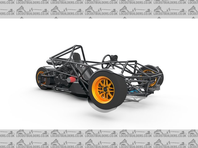

53Stix
| posted on 5/6/20 at 02:12 PM |
Hi all - hope you're keeping safe and well?
A quick progress report on Darkside, as things are moving forwards at quite a rate!
I recently launched drksd.info as means of establishing interest & awareness in the concept. I've
made no secret of my vision to be able to scale up this design to offer a credible/exciting alternative for those looking for a really immersive
driving experience, so this is a vital step in establishing some confidence in the concept.
Thankfully the initial feedback has been overwhelmingly positive, which is really encouraging!
In parallel, I've created social medial accounts on Facebook, Instagram & Twitter... I won't hound you all with requests to
follow/like/share, but clearly if you're interested in the project then it would be worth finding and tagging on to one or more of those
accounts.
Lastly, on Monday I also launched an open design competition, which aims to find a 'look' that aligns to the lean & mean design
philosophy. If it's of interest to anyone, do feel free to get involved - head to
drksd.info/competition to check it out, and also keep an eye on upcoming automotive
press/publications
Best,
-Rob
