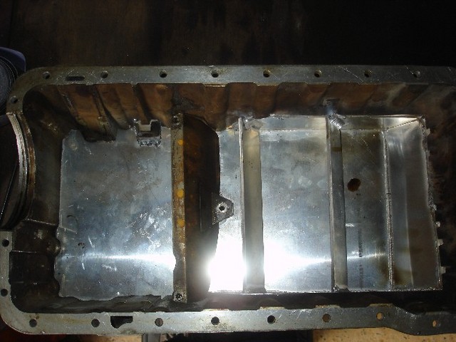

ADD
| posted on 3/8/06 at 08:18 PM |
I bit the bullet and did as I was told and had my sump shortened. Its now about 1 1/4" shorter than it was.
  sump 2
  sump 1
NS Dev
