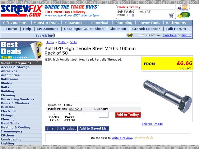

Why make everything so difficult for yourselves, just order the size you want from screwfix and get it next day
