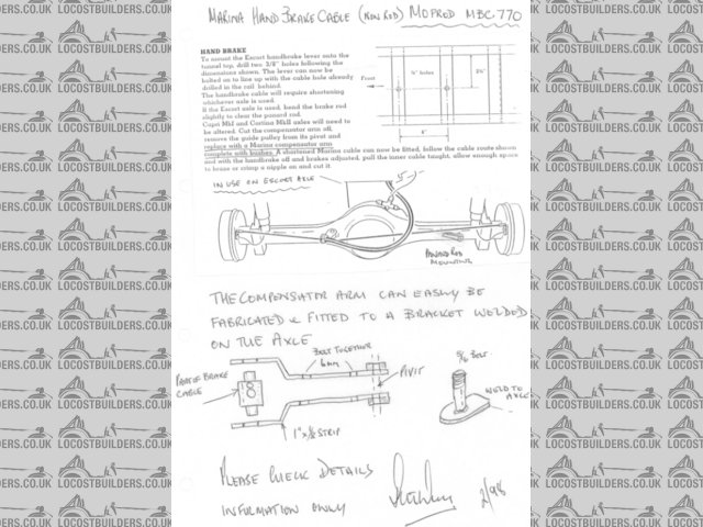

| posted on 30/7/09 at 08:52 AM |
I used the cable from a morris marina but had to make a compensator to weld on the axle, simple to make, you don need to cut the cable and get the end
bit crimped back on for SVA/IVA.
I did have a file which was taken from locostcarclub.co.uk
I have a pair of allegro inner cables which you can have for £5.00 if you want them
kj
| posted on 30/7/09 at 09:03 AM |
Just put the details in my archive under hand brake.
Also added image.
[Edited on 30/7/09 by kj]
