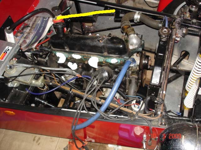

Oh dear .... but I kinda expected it ....
not good - that is a thinn knife blade and it's a tight fit.

Twat the fanimould with a hammer to put a dent in it or slot the engine mount holes to move it forward>??

Well it's out with the big ugly hammer and adjust the collector, or frame adjustment, or raise engine. IMHO you need at least 1 cm of space for
engine movement in all directions.

Big hammer.
Or rework that top tube.
(Which looks a bit agricultural anyway.)

The triangulation of the top tubes has already been lost by putting that U-shape cutout in, so why not just get rid of the problem sections?
Can't really see the point in the current cutout, it's no stronger/stiffer than the red option here:

this a photo of the top part of the chassis - if anyone wishes to make suggestions - bearing in mnd the exhaust needs to fit and noting position of
radiator which limits triangulation solutions.

Angry grind that tube out!

I'd rearrange the chasis tubes TBH - not the simplest option, but better than twatting the manifold about

Those tubes are doing nothing structurally. I'd just remove them and put a diagonal brace back towards the scuttle with a double tube down that
side.
My mates F27 has loads of room in the engine bay with his crossflow. I thought the RV8 fitted in there too?

as above . ., big hammer or grind rail off and weld it up

My vote goes for, removing the tube and forget it was ever there

hopefully my art work will show below, but basically my vote would be to remove the whole diagonal and replace with a smaller one......

alternatively just get a manifold that exits straight out the head and over the top chassis rail before it bends?

That would be the one I'd do. Had a similar experience with a narrow Westfield when I decided to put in a gear reduction starter, the gear
thingy on the side of the main motor body hit the chassis in a big way. Just cut it and rewelded it in a different direction. You could smash the
bejesus out of it but would you be pleased with that?

How about modding the rail like this:

The classic fix in this case is the Y brace:
  Engine bay Y brace
The angle of the long part of the brace w.r.t the chassis rail should be made as wide as possible; there seems to be a fair bit of clearance between
the outside of the collector and the chassis rail which should make this possible.

when I mocked up with a different head, there was about 10 mm or more clearance as well as the exahsut exiting centrally - it is a bit off there as
well.

Change the radiator to the other side of the traverse tube, you may want to modify your Thermostat housing so it exits toward the fronto of the
car.
Then use the suggested solution above by MikeRJ
