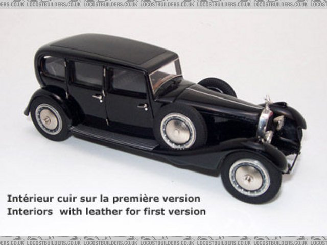

Cheers At first I was looking at using an extended Range Rover chassis but there’s an number of problems, one is the front doesn’t taper
sufficiently to meet the narrow radiator grill so the chassis rails would stick out under the wings and second the kick ups front and back are very
small which they need to be on a Land Rover to get the ground clearance but would make a saloon car too tall. By the time I’d altered the chassis I
might have well just made a new one that was correct from the start. I haven’t ruled out it having 4wd as I’d like that if possible
Though 3mm seems a good thickness for a road car. I was really wondering what the steel grade would be called, there’s so many.

You really got me thinking.
Firstly, to get the proportions of the Bugatti Type 41 Park ward is very hard with modern (affordable) mechanicals. The wheels of the bug are
24"!
With 15 or 16" rims it is hard to match the proportions (and still have any usable interior space)
I would suggest to have a look a the sports saloons that were build in the late thirties.
The proportions of these cars are easier to capture.
So my plan would be (just a suggestion):
running gear: Ford Cortina/ Sierra/ BMW E30/36/ Triumph TR
This would enable to have a track around 1,4m (+/- 5%) and the final touch would be 205/70R15 tyres to get the correct wheel diameter.
These cars offers also plenty of engine choices.
The wheelbase should end around 290cm /- 5%).
For the chassis I would use 100x50x3mm section. The rear section should kick up 20cm and the front section would have 10cm step.
The body would be constructed from 25x25x1.5mm sections with 16swg steel plate (also used for the floor). Interior space would be around 2 metres long
120cm high and 135cm wide.
Perhaps put some integrated rollcage (50x2.5mm?) for safety.
The other dimensions are:
length: 4,5m
width: 1,7m
height: 1,45m
Sofar my 0.5 cents
