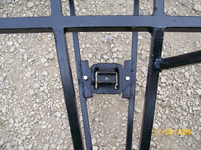

Daddylonglegs
posted on 7/11/09 at 05:34 PM Reply With Quote
This was my solution. Just ground off the rivets from the original Sierra one and used the base plate and rubber.
Gearbox Mount
Gearbox Mount
HTH
JB

posted on 8/11/09 at 10:26 AM Reply With Quote
I did the same as daddylonglegs - used the centre part of the standard Sierra mount.
Remember to use the peculiar bell-shaped washer that goes onto the bolt underneath the mount - it reduces the amount that the rubber can move around.
Mark Allanson
posted on 8/11/09 at 11:38 AM Reply With Quote
I tried that, but the Sierra mount gave so much movement that the gearbox could hit the chassis on both sides, the westy one is almost rigid.
