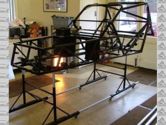

Wanted pictures of raw striker roll cage
Hi all
Going to get fitted a roll cage and side impact bars next week and looking for ideas and inspiration,
I was hoping to get some close ups of how you or raw have welded in the front hoop to behind the dash,
Like photo link attached,
Or if you have it a chassis pic with the full bare look,
Appreciate any pics
Link
http://www.flickr.com/photos/querth/3362760593/

INDY BIRD
| posted on 27/10/12 at 08:49 PM |
Like this where the dash bar meets chassis how this welds in?
Link
http://classifieds.pistonheads.com/classifieds/advertgallery/830394/4
Thanks all
bi22le
| posted on 27/10/12 at 09:08 PM |
Most of the ones I have seen the rollcage goes outside the dash down the side of the car. Extra welded plate on the inside the bolted through the
side. These are the first ones I have seen that go through the dash.

loggyboy
| posted on 28/10/12 at 09:06 AM |
I assume your talking about a classic striker set up with the triangular skuttle. Where as the fulcrum and mine are based on the optional
'modern' style:
Heres some others ive seen:
  RawStrikerNorthDemoChassis
http://www.rsfabrications.com/2009/07/09/striker-raw-with-toyota-4ag-motor-gets-silencer-for-track-days/

Mistral Motorsport
Rich J
| posted on 28/10/12 at 10:43 AM |
side
Thtas the way I've done mine. I wanted it removeable so it's not ideal I know as the bolts are in shear
