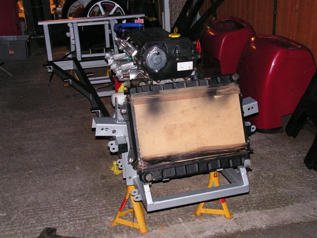

From http://www.locust.org.uk/ownerscars/builds/bob_baines/bob_baines.htm
Anonymous
