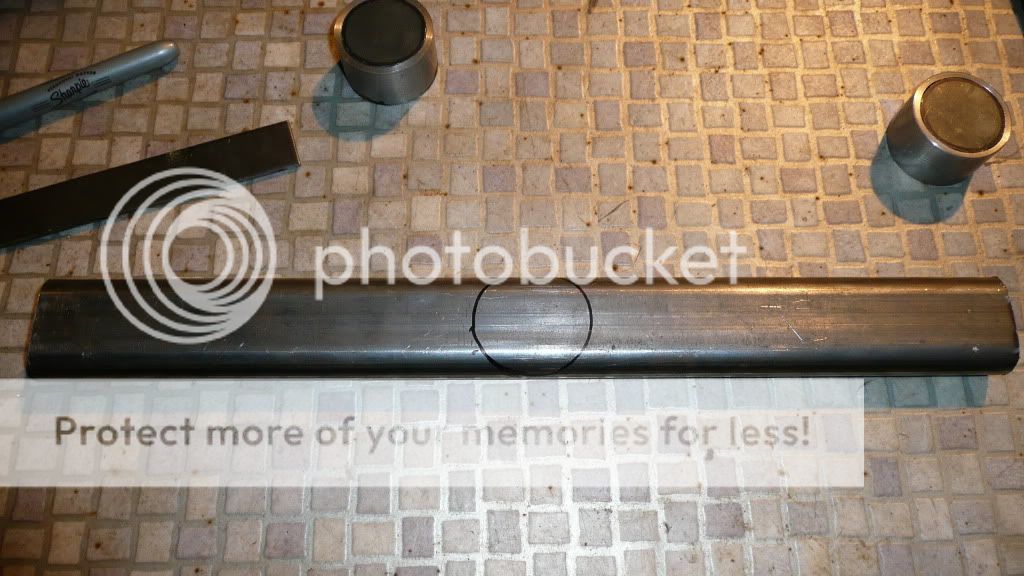

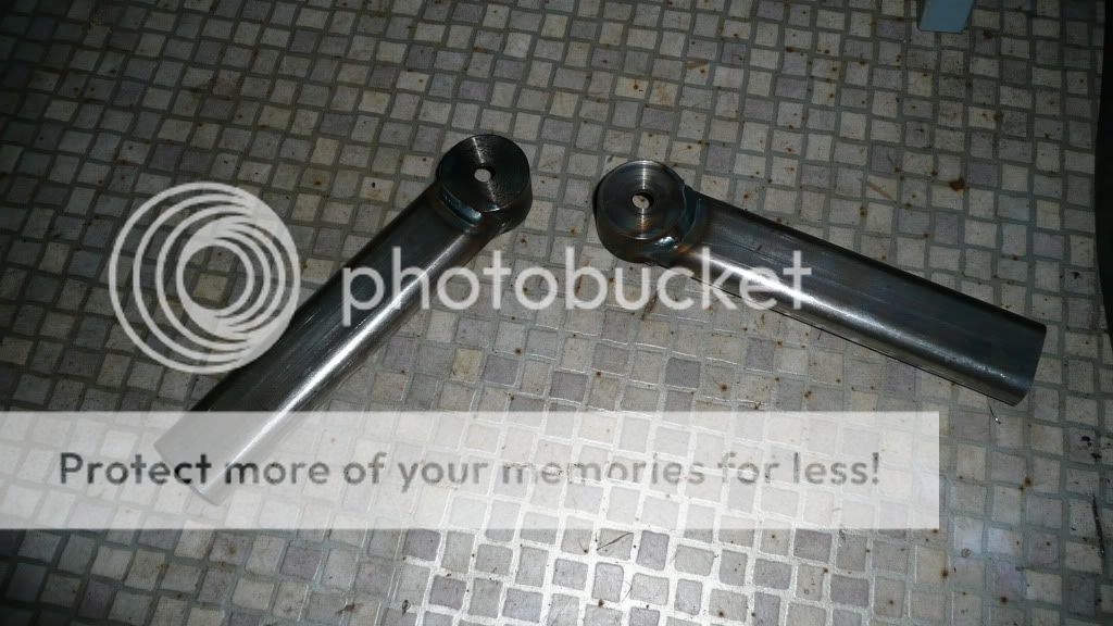

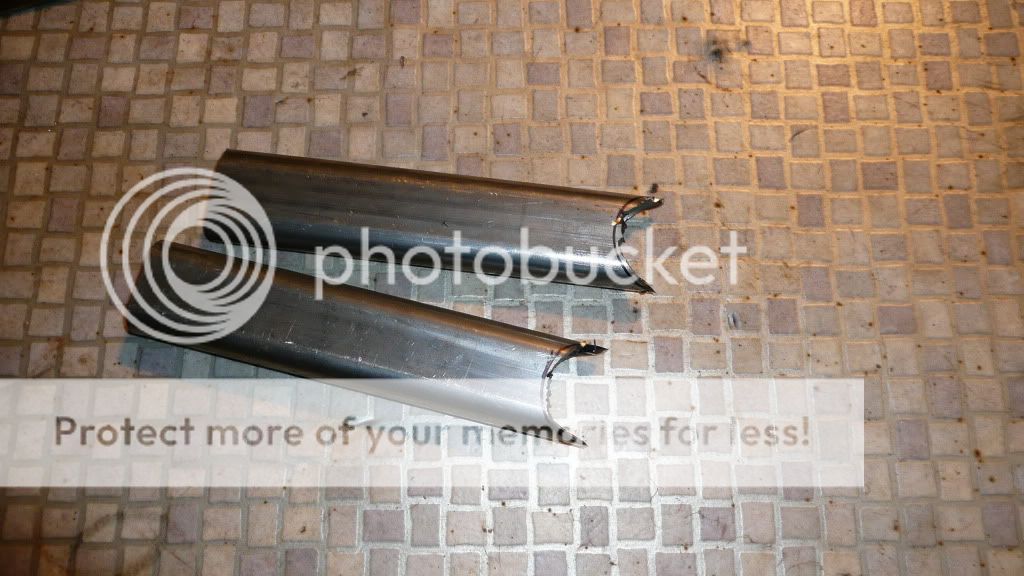

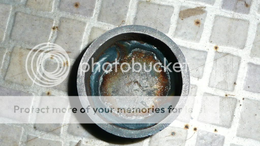

ashg
posted on 29/6/14 at 11:30 AM Reply With Quote

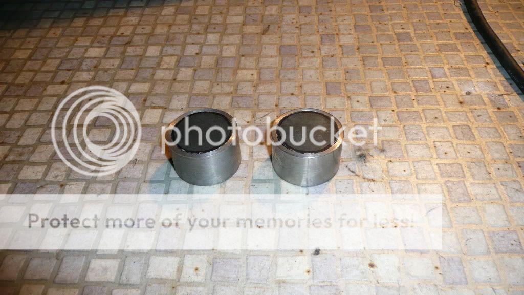

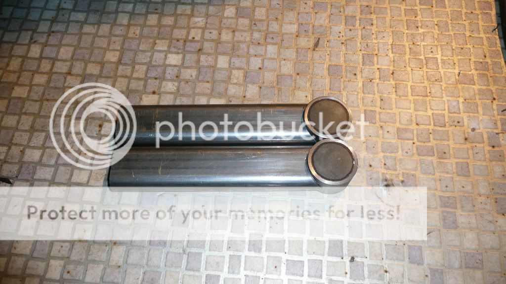

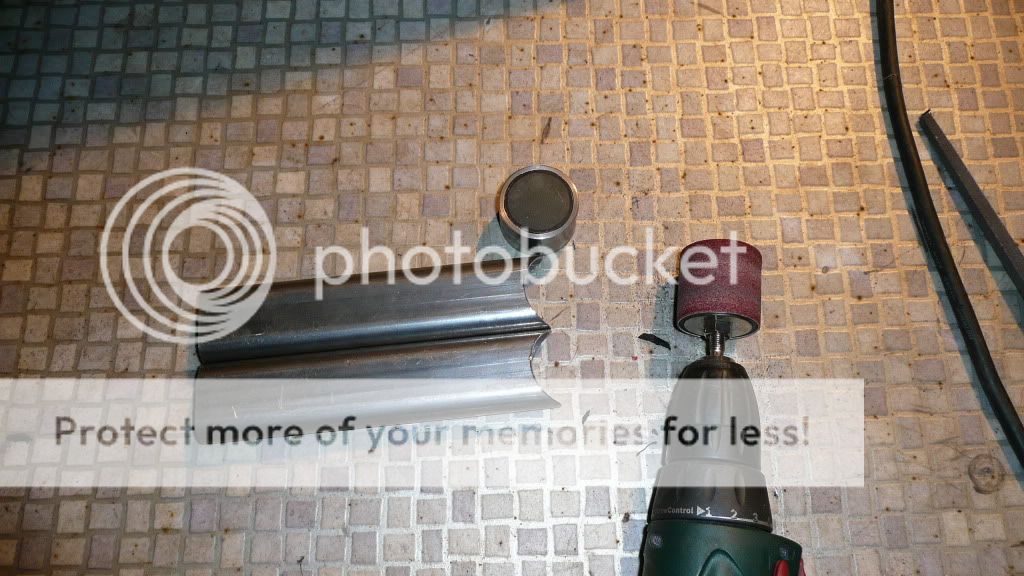

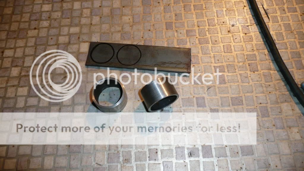

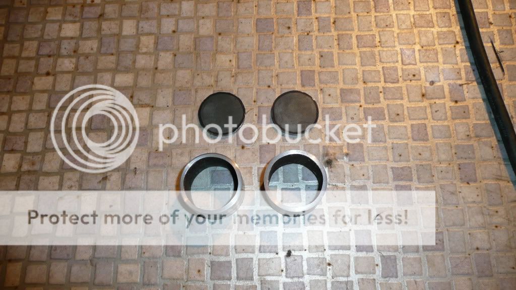

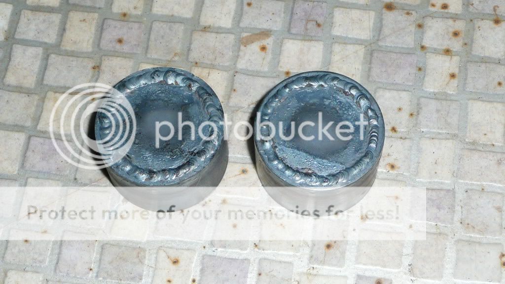

And this is how its done when you have the lights
