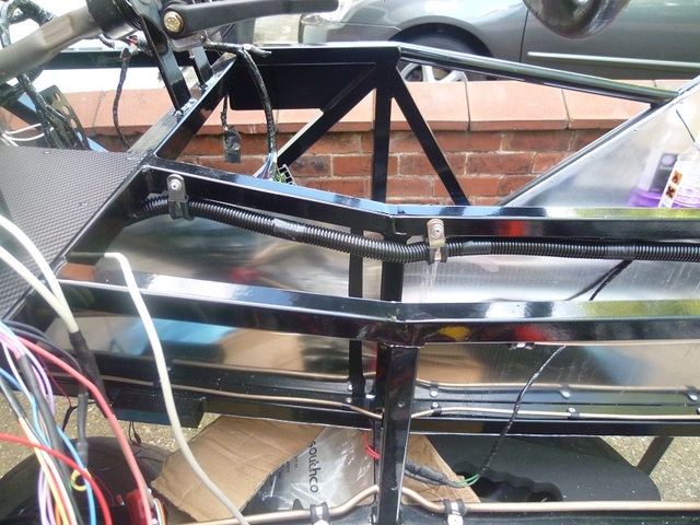

neilp1
| posted on 28/6/15 at 04:38 PM |
This is how I done mine

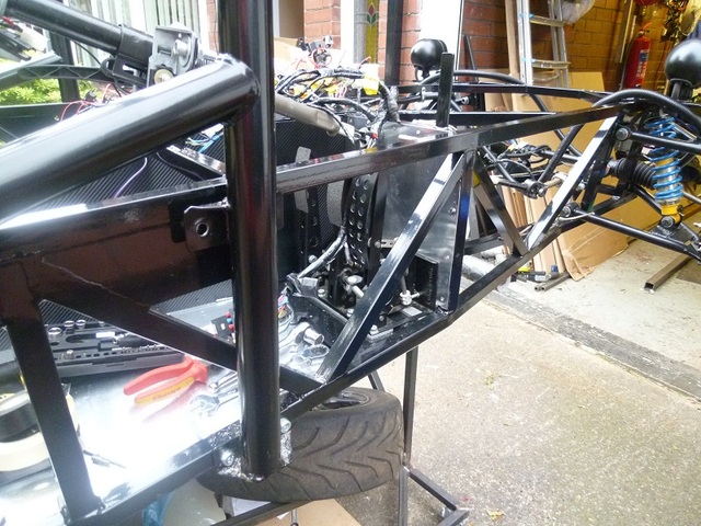

| posted on 28/6/15 at 08:28 PM |
I'll post some pics tomorrow. I drill and trial fitted all my panel and then left the tunnel until I had wiring loom, brake and fuel lines in. I
then fitted the front drivers part of the tunnel before the pedals as it is very tight with pedals in place
neilp1
| posted on 30/6/15 at 04:20 PM |
Here is some pics
Lander
| posted on 2/7/15 at 09:21 PM |
Thanks Neil, great pics thanks
