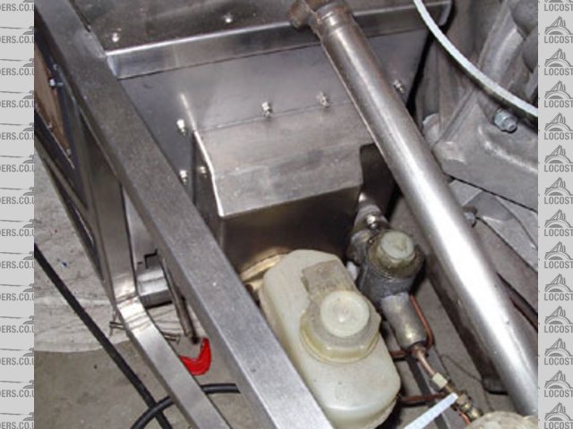

If you are building then there's a way of increasing the footwell length by 75 to 100mm,
without changing any chassis dimensions.
I'm actually considering moving my seats forward as I may have overdone things.
If buying then you can only get what's available.
Paul G

907
posted on 12/8/15 at 05:01 PM Reply With Quote
Originally posted by Tugchaser
907.
In which car can I get an extra 75 -100mm? I have never heard of a Sotul & Googling it didn't help much either apart from an early 90's reference.
Pojo
You are about 100 miles from me. When I have made sure that I am not wasting your time I may well get back to you regarding a look at yours. Allowing for soon to be taken holidays that will take a few weeks. It is always interesting to talk to someone who has experience.
Thank you.
Hi Tugchaser,
It's called a Suttol (almost Lotus backwards) and it's so rare that Google hasn't been told about it yet. Details of it will only become
public four minutes after it's blown up.
(note. I added the second "T" to it's name because David Jenkins kept calling it a "Sooooooo tol" )
What I did was to cut a hole in the end footwell plate and fit a box shape in, effectively extending the footwell length.
The bottom mounted pedals then pivot on the footwell end chassis cross member and the box allows room for M/C pushrods.
See pics. ( my box is stepped as the clutch required 50mm and the brakes 75mm. )
No pedal box to use up space and all the footwell space for your feet.
The car is standard Locost length and plus 4" in width to suit Sierra diff & driveshafts, and wide engine.
Paul G
