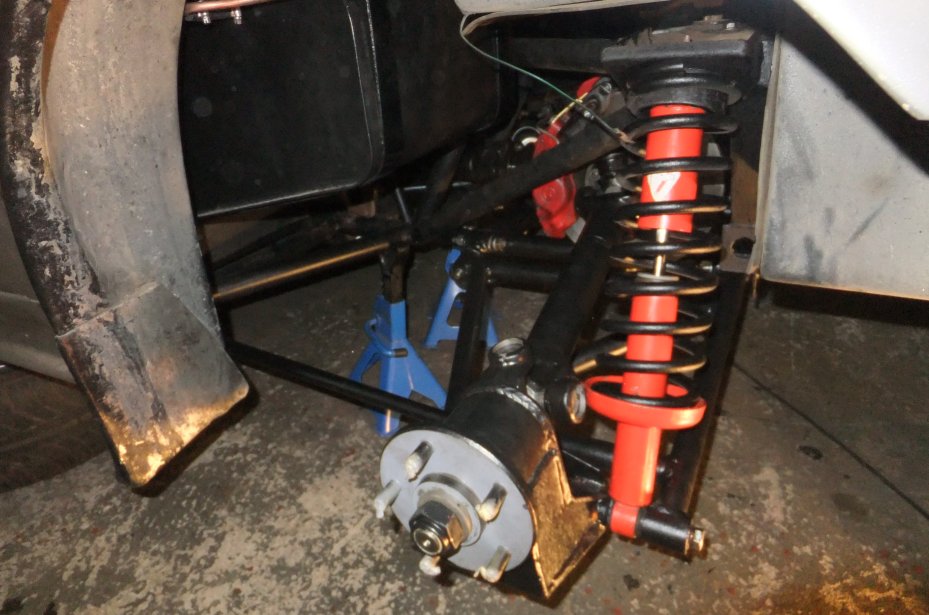

this is what I mean..
thanks

Now I can see what you mean! The top mounting of the coil-over strut is fixed, whereas the lower end, which is fixed to the hub carrier, has to move
with a small degree of circular locus. This tends to reduce the wheelbase very slightly. Not 100% sure about the camber angle, but I suspect it
changes.
I'm interested to read what the LCB collective might comment.

1) 'Genuine' Cortina uprights are now getting rare and in any case, being cast iron, are not sensibly capable of being modified to meet
your requirements. There are several companies who make aluminium replacements to identical geometry, however, and some of these would be easy enough
to modify for a dropped spindle position. For example, we're working with Hi-Spec, who have been helpful in supplying modified uprights to our
requirements; this is an image of the CAD model for their 'Cortina' front upright, and you can see that it would be easy to raise the
spindle position:

You wouldn't need to modify the casting, and they will alter the machining to suit your required dimensions. As you can see from the drawing I
posted above, it's simply a matter of raising the position that it's drilled & countersunk for the spindle (stub axle).
Edited to to add image of the same upright:
The Mustang upright is quite different geometry, incidentally, so would require a comprehensive redesign of the suspension.
