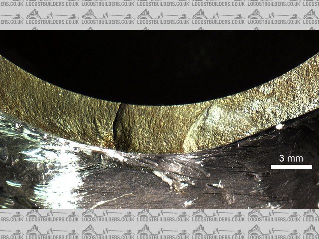

On a recent job at work we faced a number of failed pipe nipples at a gas plant (potential for a big bang)
Following this I spent a lot of hours finding out why and in the process learned a lot more about how low carbon stainless alloys behave.
At the lower end many stainless steels have a fairly high carbon content and are very similar in mechanical behavior to normal low carbon steel. What
they are though is very sensitive to to structural change from a whole host of variables but done correctly they are quite good at dealing with
vibration.
Problems mainly come from incorrect weld procedures and incompatible filler rods either from MIG, TIG, MMA or STT welding methods.
Incorrect Shielding during TIG / MIG. Using Common Argo Shield gas and not high purity Argon.
Excess heat input coupled with poor shielding makes the metal coke up on the back side or inside box section where you cant see. All these leave
sub-surface flaws or affects the grain structure where a crack can propagate. the speed of the crack growth is linked to the natural frequency of the
assembly matching that of the vibration source. Since in a car the vibration source frequency moves so much with revs / gears / road surface all the
ingredients for failure are there already.
The next part that affects the grain structure is contamination, any kind of containment left on the area being welded can melt and be sucked into the
weld pool, when it cools you have a different micro structure and beginning of a failure point. This failure point can like what was in our case not
even be in the weld pool but the edge of the heat effected zone.
Trying not to bore everybody but I found it fascinating, it turned out that our failed pipes were from residual contamination on the surface being
welded of a zinc based paint on adjacent pipes caused the subsurface cracking and loss of production in the facility close to $150m in the end.
Metallurgical analysis of the failed pipe nipple showed evidence that the failure was due to liquid metal embrittlement, with the liquid metal being
zinc. During the welding operation zinc residue from previous coatings in contact with the components being welded, melted, and diffused along grain
boundaries, lowering interfacial energies where present. At some point in time, most probably during weld cool down, the strain energy developed
caused cracks to initiate. Propagation of the initiated crack may have been promoted by continued diffusion, system static loads, cycling frequency
loads during operation of the unit.
So in short it can be used but the risk for out weighs the rewards, specially doing dissimilar welds of carbon steel to SS which can be done with the
right materials and procedures.
Macro Picture of the crack cross section
  Picture of Crack
Electron Micro-graph of the sectioned crack
  X-Ray
Higher Magnification, note the sub surface cracks which initiated the failure and sharp crystal formation
  micrograph
