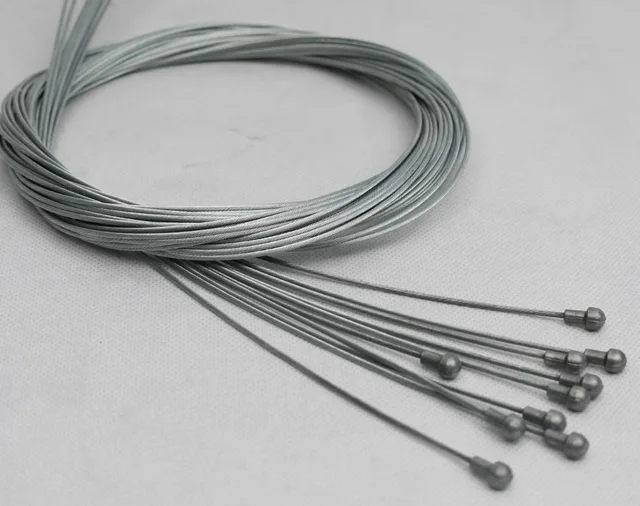

Lazy question, as I could just look at my carb when I get home but....
Does there tend to be a clamp at the carb end of the throttle cable that allows for adjustment. I.e. you draw the cable through some kind of clamp and
then bolt it down when it's the at the right tension?
If it does - something like this:
looks the ideal way to attach the end of a standard bicycle brake inner cable like this, to the accelerator pedal:
And if the split pin was replaced with an 'R' pin - even easier to change?
