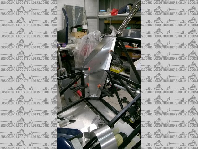

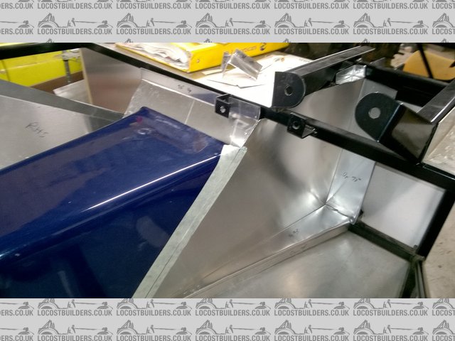

Yeah I also got 1050A H14 (probably on John's recommendation) in 1.2mm thick, but I was only getting extra sheets for the awkward little panels
around the tunnel and in the rear corners and such
my dax came with all the main alloy panels pre-cut - If I was going to do all the larger flat panels I'd have been tempted to get some harder
maybe even 5251 H22 or similar - but I'd have still needed some 1050A H14 for these tricky bits

second that - even an idiot like me can make half decent panels
  Rear corner alloy v3
  new footwell
(don't worry I know its not even close to John's standards - but its getting covered afterwards)
