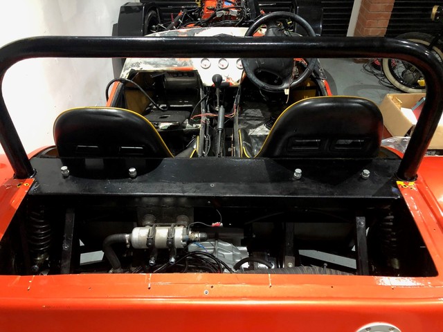

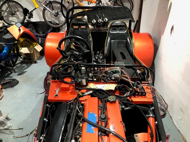

Hi All,
I have recently purchased a part built kit car. The chassis is stamped as an MK Indy, but after speaking to MK they are saying it is not theirs.
I have sent a letter to DVLA to check on the chassis number.
After some research I have noticed a few people on here have owned this car.
So I'm asking does anybody have an idea of what kit it is, so I can hopefully get this car finally on the road.
If I need to purchase a new chassis or change the VIN number I will do it.
Thanks in advance

I've just changed the photo to the chassis in question
jacko
| posted on 6/1/21 at 07:02 PM |
It’s not a mk Indy looking. At the chassis
But the body panels do look like mk panels
The suspension is not mk

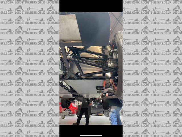

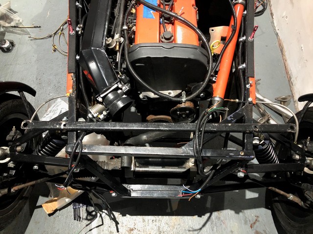

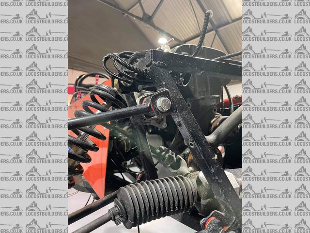

MikeR
| posted on 6/1/21 at 11:07 PM |
The front bracing isn't early or late MK. Nor is it GTS.
The missing front offside brace needs correcting - but i've told you that before. If you look up the plans here you'll get an idea what it
should look like - http://sevenesque.com/plans/
The front chassis tube near the suspension mounts looks like its got a plastic bung in it to fill the hole that is normally welded up. It also has a
hole in the tube for some reason which i'm struggling to understand.
I've not seen any of the major manufactures produce a rear section that the roll bar mounts onto like you have - but i don't often look at
that part so it could just be my lack of knowledge & i'm struggling to remember what GTS did at that point.
I'd suggest you've got a home built car that has been made to look like a MK. I wonder if someone got the body work cheap and then tried
to make the car match the bodywork?

MikeR
| posted on 7/1/21 at 10:04 AM |
Sorry, thought you were the post I responded to on Facebook last week. The picture look the same.
The chassis has been engraved with a mk vin number which matches the vin on the body work. As the poster said, mk are denying that vin number is
theres.
The simple course is action is weld over the engraved vin with a stamped vin. Remove the mk plate listing a vin and create your own. Job done. Just
make sure the vin is to DVLA requirements.
Id then look to fix anything else, get it IVA'd and on the road.
Good luck.

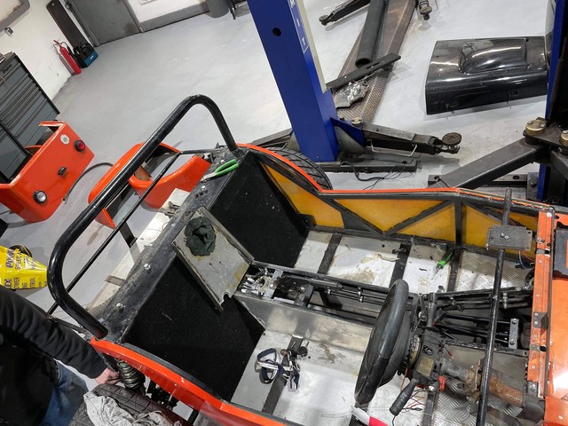

| posted on 7/1/21 at 10:08 AM |
Having built an MK Indy myself the chassis in your photos doesn't look like an MK Indy to me. For a start the MK Indy I built had bent box
section in the chassis (front and rear) and I don't see that in yours. I can see places I'd add some additional chassis members for
additional bracing. To do that would require stripping down quite a bit of the car or section of the car and cutting/welding/painting.
Aside from that I'm afraid I can't offer any advice as to a particular make or model of chassis.

MikeR
| posted on 7/1/21 at 07:02 PM |
Mk did make straight tube chassis before the bent tube, but they didn't have independent rear suspension.
The link I sent you will show you where the chassis tubes should be from the seat forwards. I think you're missing 2 tubes (although mk never
fitted 1 of those). The one I described, plus another from where it attaches to the side of the chassis to the middle by your feet.
How high is the chassis from the bottom to top chassis rail?
MikeR
| posted on 7/1/21 at 07:10 PM |
Also, I don't think it's necessarily a bad chassis, I'd just want the missing bits of bracing adding.

macboycie
| posted on 7/1/21 at 07:33 PM |
It's interesting that you say that about MK as it has had a new complete Independent rear suspension added with LSD Sierra diff.
The one missing, I was going to do the same at the rear of the engine department to strengthen.
The chassis is 460mm bottom to top
