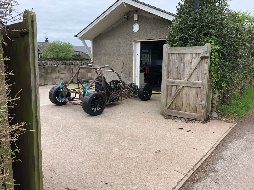

Nice morning rolling the locost out of the garage for the very first time, managed to not run into ground clearance issues and I’m reasonably happy
now with the suspension set up, though the alignment needs a good going through, think I’m in a position to finalise the uprights and started looking
where I can get these made.
Body work is going to be exciting. Hoping to get the running gear done this year then start on body work next year. My mate asked me how far on I’m
with it, I’d guess only around 20%.....

Progress is progress but it’s the last 5% that takes the longest but it doesn’t ever have to be finished if it keeps you happy and keeps the grey
matter turning.

| posted on 3/5/22 at 06:37 AM |
Top work, looks superb
| posted on 3/5/22 at 06:44 AM |
For me, the roll-out was when it started to look and feel like the makings of a real car, rather than a heap of metal in the garage.
Looks good!

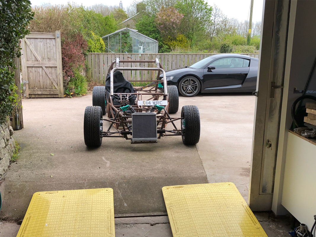

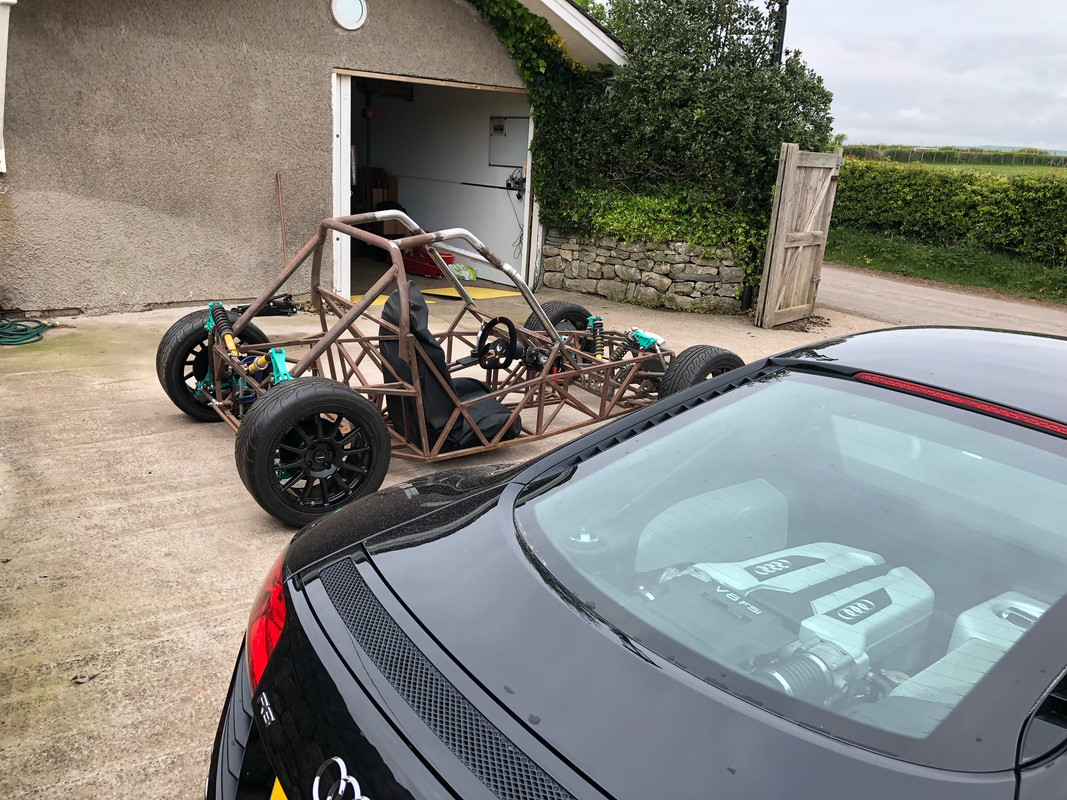

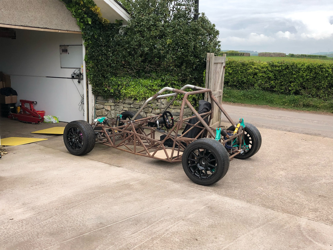

| posted on 3/5/22 at 08:50 AM |
Looking good.
Are you adding side impact bars to your roll cage.
Also, I noticed that the rear coil over mounting points have no triangulation to stiffen the top rail.
Sorry if these are already in the pipe line.
b14wrc
| posted on 3/5/22 at 10:41 AM |
Gear box mount is going to incorporate an extra tube. Also have an ARB to figure out the mounting for.
Hadn’t thought of a side bar, maybe a bolt on bar could be added though, thanks.
