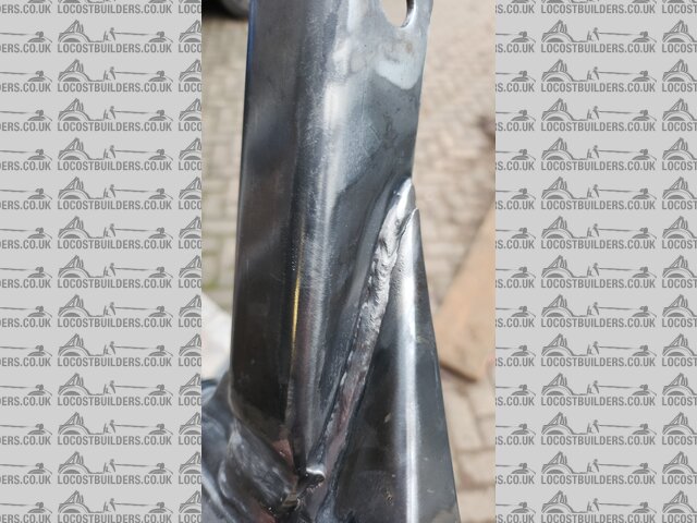

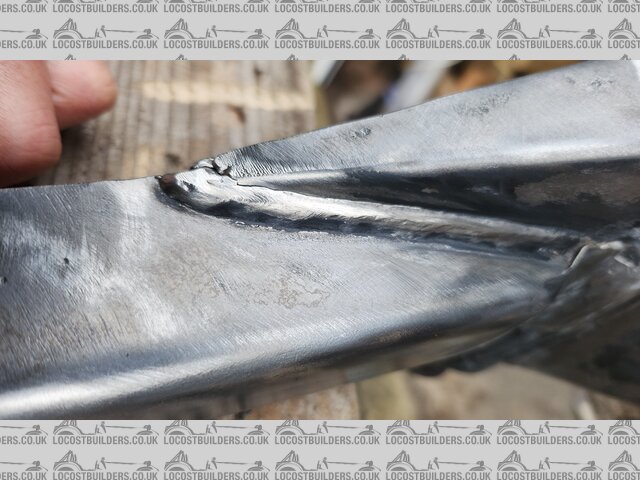

| posted on 7/12/24 at 09:59 AM |
Checked all the wish bones for cracks etc and so far all good
L so these have been blasted, zinc primed and powder coated.
I didn't want to blast and powder the rocker needle roller as they are good and the oven would of done no good so decided to strip and 2k Paint,
I could of got away with repainting as they were ok'ish but glad I did. Cracks along welds on both sides.
Apart from that it's getting there slowly. Wil add some more photos up soon..
