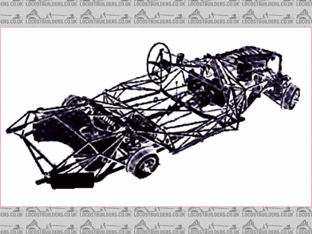

I thought to lower N1 and N2 and than to ad one more “wing” tube on each side parallel to N1, N2.Something similar to solution used in Mercedes Benz
chassis (Guldwing era).
Unfortunately for some reason I can’t attach pic’s .I don’t know much about car mechanics and I will try to stay as much as I can “by the book” when
it’s up to chassis, although I don’t like the shape of the rear end, it’s to box-y for my taste.

Mercedes SLR space chassis that I mean to incorporate in Locost chassis , at least side bars.
