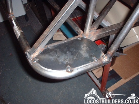

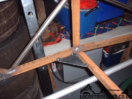

The following pics show the plates that wil be fully welded to my chassis.
Are you saying that I should also weld a plate the same size onto the ends of the roll bars and then bolt?
What would I need to do to comply with the MSA regs?
Any ideas for the main "normal" hoop mountings that won't interfere with the shocker bracket underneath?
Pat...

Fozzie
posted on 20/7/05 at 11:08 PM Reply With Quote
Yes, absolutely...
MSA...Have to consult the latest Blue Book, mines being 'borrowed' at the moment, but, IIRC there are a few options, and include a good diagram of the 'spreader' do you know a mate nearby you that has one?...worth a squizz.
Shocker bracket.....Threaded steel bushes, welded into the tubes.
HTH Fozzie
Fozzie
posted on 20/7/05 at 11:13 PM Reply With Quote
Pat,
Your front plates are sadly not big enough or strong enough.
The plate should ideally be 5 inches x 5 inches and the plate at least 3mm thick, (same for all 6 plates)
Fozzie
Avoneer
posted on 20/7/05 at 11:19 PM Reply With Quote
Will re-do the front ones and make them bigger. They are 4" on the sides and made from 3mm plate though.
Have you used 4 bolts on all the plates then?
Saying that, might be easier now to weld said spreader plates to the tubes and weld the whole thing in place!
Do you think I will need spreader plates on the "normal" hoop?
Pat...
Fozzie
posted on 21/7/05 at 07:05 PM Reply With Quote
Sorry for delay Pat... I needed to confer on one of ya questions.
The way the front legs come down, means only 3 bolts on those.
We have a difference here in fozzie-land, I reckon there are 4 bolts on the very rear, t'other half says 3.....ah well, I will go stick me head down the rear (ooeer) later to confirm!
Yes, (for safety) you will need spreader plates on the hoop!
