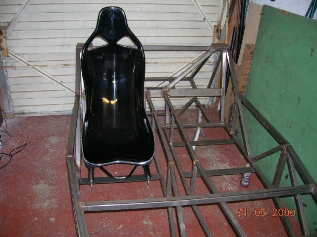

I have chosen to use some 3mm plate 2inches wide to bolt the seat runners too and I’m now having second thoughts as to its strength.
The floor is going to be bonded/riveted aluminium. I'm also planning to add a strip if 3mm plate going the length of the runner so that it is
fully supported.
Is this enough or will my seat be a bit wobbly?
I was hoping not to use 25mm box because it raises the seat another 25mm causing other issues with seat belt mountings.
Anyway, this is what i have done so far, what do you think?
  Seat Mounts 2
[Edited on 5/6/06 by birdii]

Probably o.k The caterham seats I have use 3-4mm strips allong the runners that then fold up into a Z at the end to attache to the top of the chassis
box section running acrosss the chassis.

All the MK Indy has got is about the same as u have at the moment once u have bonded and riveted the floor on all u need to use big washers on the
under side
You can see in photo
  Descriptionfloor

Maybe if you use some angle with a small return? It might off a little more strength.
Raz

You could also add another strip under the car. Or if you're really bored, add angle under the car, and place it so it'll create a nice
under tray addition running front to back.

Thanks for the replies!
It looks like what i have done isn't far off what some manufacturers are doing so i'll go along with it how it is and see how I get on
when it eventually hits the road!
