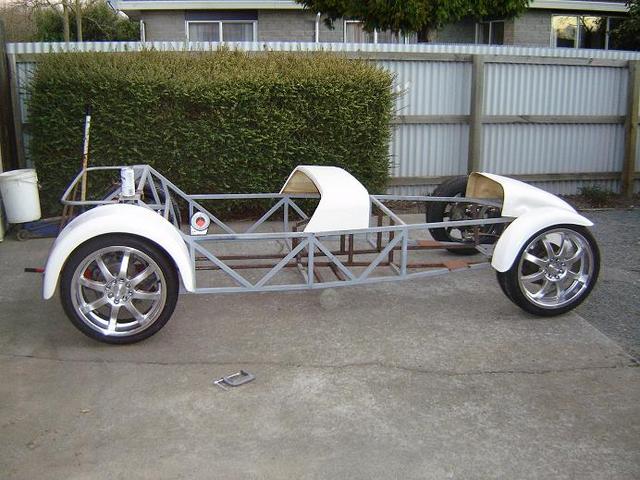

Had a productive weekend , got my front wish bones on and got it on four wheels , Its no longer a pile os steel sticks on a table , Was so happy I
went out and brought new wheels for it .

I see you took a drink on that

vorn
posted on 10/9/06 at 09:59 AM |
at last
sure did , sat for about 4 cans looking at it feeling pretty good about myself .
now just have to put the motor back in and drill mount holes and then the steering . sure that will take a few more cans

looks neat and tidy so far keep the pics coming
well drink after the motors in!!don't want to co*k it up

vorn
| posted on 10/9/06 at 10:08 AM |
at last
the more beer the straighter it looks It has been in . was waiting to see what sort of ride height I would get befor I went too far . With
17' wheels It seems to have heaps of ground clearance.

martthefridgeman
| posted on 10/9/06 at 10:58 AM |
what wheels are you using, they look very nice. MJA
Guinness
| posted on 10/9/06 at 12:02 PM |
You forget how good a white 7 looks!
Are you going for ally sides or more white fibreglass?
Looking good.

ex-ctr
| posted on 10/9/06 at 12:39 PM |
looking good and im going the same route with a ca18det
could anyone tell me where i could get bodywork the same in the uk

vorn
| posted on 10/9/06 at 09:27 PM |
Thanks "martthefridgeman" The brand is K-Sport but I think they are made by "avanti"
vorn
| posted on 10/9/06 at 10:22 PM |
Thanks "Guinness" I thought the same about the white , only got it in white because thats the colour it came in , was going to paint it
orange and black
